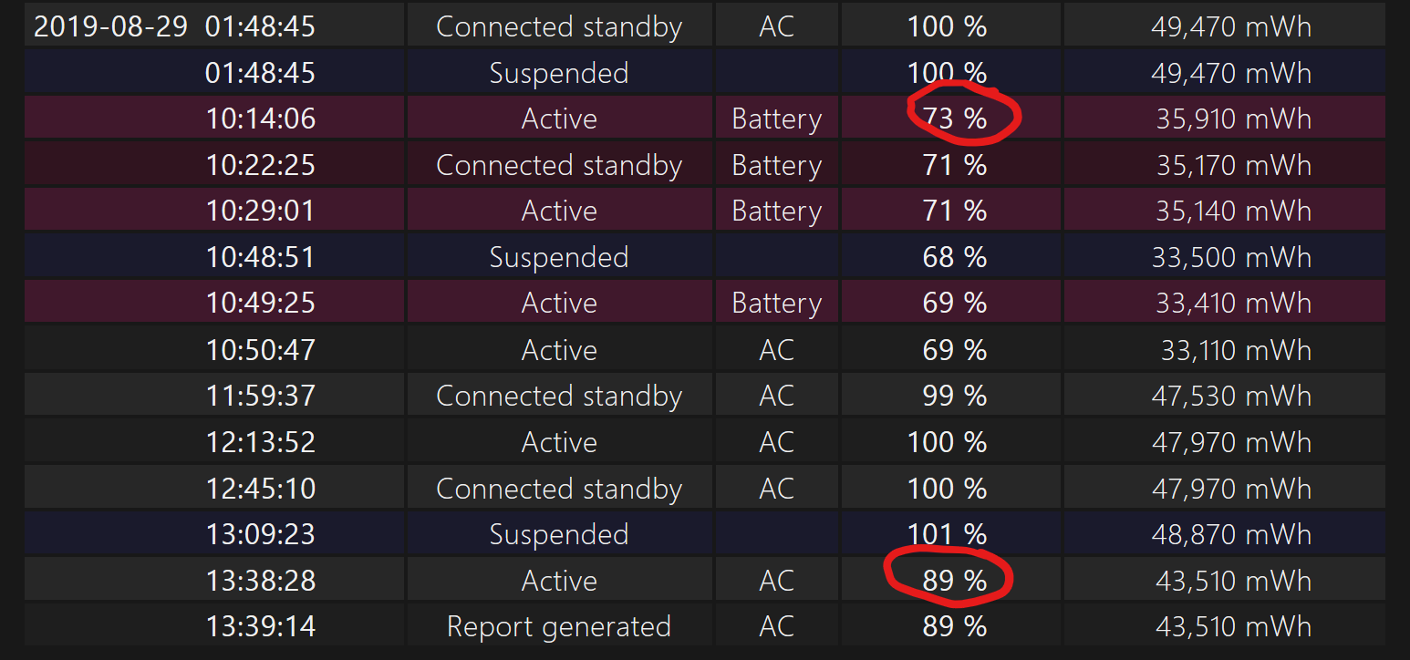

    It's firmware issue not windows update. Flashing back to older version won't change the firmware.
    2019-09-16T16:24:11+00:00
    I have the same issue. It seems not an issue of software because I used USB disk to refresh my system into the very old version 1803 and banned the windows updata service. But only after one day, the battery drain issue occured again. So, to refresh the system can not solve the issue.
    The most strange thing is that you can get 1-2 times of shutting down without battery drain when the system was refreshed/restored.
    The typecover seems not to cause the issue in my Pro6.
