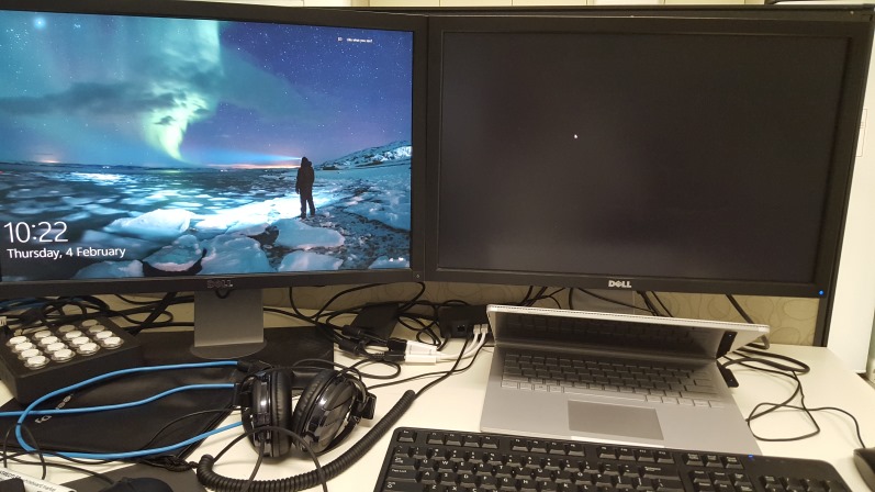

    Our office has experienced the same lid closing problem where the WIFI signal dies when docked and the lid is down. Using inSSIDer , it's quite easy to see the signal strength drop off 15-20db as soon as the lid closes and step back up as soon as the lid opens.

    I will +1 this thread. I am experiencing the same issue with my Surface Book. Currently I use an external dock and need to leave my lid open half way in order to receive a usable WiFi signal. With the lid closed the signal strength deteriorates with a lot of packet loss. Typically I am unable to stay connected to the WiFi network.

    some people have found relief by using a USB extension cable. my guess is that
    this is a shielding issue. I don't know if or when this might be addressed or
    even if Microsoft CAN address it.
