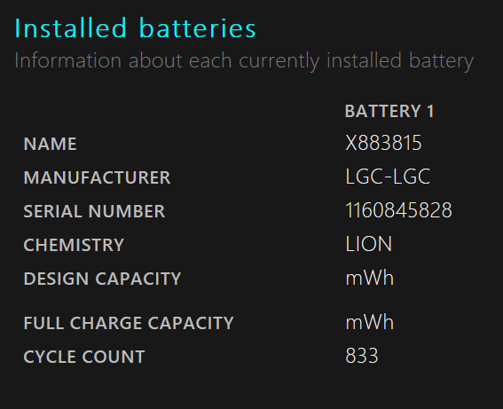

I've been using Microsoft Surface Pro 3 for a year, and shortly after the warranty expired I noticed my Surface Pro 3 can only last about 1-2 hours after a full charge. At first I thought this was a problem with background process draining the battery so I disabled everything running in the background. It didn't helped. Then I found out about the powercfg utility and run powercfg /batteryreport on it, and this was the result:
A full charge capacity has degraded by over 80% in just few weeks and continue degrading. I tried to "recalibrate" the battery by doing full charge then full drain multiple times, and it didn't helped. Talk with Microsoft via chat support and they insist this was a software problem and reinstalled the driver and asked me to wait few days to see if things improve. Not only it didn't improved, but now my Surface can only last 30 minutes.
Few days after chat (today), I called Microsoft support and they were being extremely unhelpful. Insist that this was a software problem (which the chat support person already did) and it's "perfectly normal" for battery capacity to degrade. I insist that I've already done the software "fixes" and it didn't work and tell them this is definitely hardware problem, but the person on the phone tell me there's nothing I could do except to order the out of warranty exchange (which cost about $560 in my local currency).

    I have a SP3 with a SIMPLO Battery that has some issues.
    It refuses to charge nor discharge (stuck at 54%, plugged in, not charging) and the Surface doesn't power up without AC connected. If it has AC connected, it starts up, but the moment i take out AC it turns off immediately.

    The only difference I have is that is is stuck "88%, plugged in, not charging". Same exact thing - if you bump magnetic plug, it is like pulling the battery out. Grrrr. Happened only a couple months after warranty expired. Installed the firmware upgrade, upgraded from 8.1 to Windows 10 - nothing. Tried completely wiping/reformatting/restore to factory settings, but now every time I try to do any upgrades, it flashes “Surface” then “Preparing Automatic Repair” then light blue screen of death “:-( your PC ran into a problem and needs to restart. We’re just collecting some error info, and then we’ll restart for you.” Then it cycles back to the black screen “Surface . . . Preparing Automatic Repair” and stays in a loop until hold down power button.
    Finally got it to a point where it will run, but won't update? Wasted hours.

    I was actually able to almost fix my issue!
    I created a flash drive with the media creation tool which now makes build 14393 (the anniversary update) and completely wiped my SP3 and installed a clean Windows on it. It found only 4 updates after that and interestingly enough the November firmware update was again one of them (I've already applied it once before).
    After that I did a test with YouTube nonstop in Chrome and it lasted 4 hours 30 minutes before going to hibernate due to low battery.
    Under normal conditions it shows almost 6 hours on a full charge.
    Still no mAh data in the battery report but maybe it needs more cycles to calibrate...
