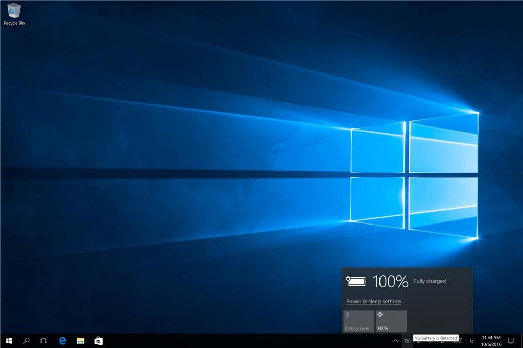

    Has anybody found a way to install the firmware when your battery level is under 40%?
    I have tried everything and nothing seems to work! It's really frustrating :(
    Imposing a battery level barrier for the firmware fixing the same faulty battery is absurd.
    Isn't there anybody who has the same problem as me?
    I first updated my firmware using Windows Update and followed up the two restart instruction but it didn't work.
    Then I downloaded the firmware manually and installed it but it didn't work either.
    While booting, firmware update progress bar goes near 100% and then device restarts and when I log on I see that the firmware isn't installed.
    Now my battery status icon in task bar shows "No battery detected" but when I click on it shows my battery is fully charged.
