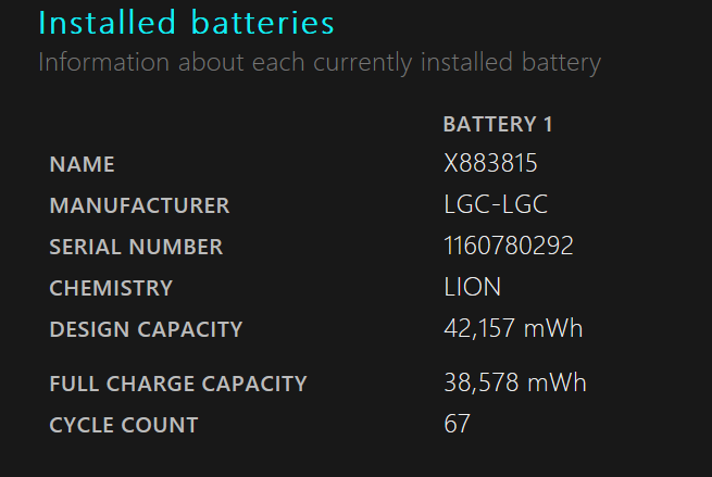

I've been using Microsoft Surface Pro 3 for a year, and shortly after the warranty expired I noticed my Surface Pro 3 can only last about 1-2 hours after a full charge. At first I thought this was a problem with background process draining the battery so I disabled everything running in the background. It didn't helped. Then I found out about the powercfg utility and run powercfg /batteryreport on it, and this was the result:
A full charge capacity has degraded by over 80% in just few weeks and continue degrading. I tried to "recalibrate" the battery by doing full charge then full drain multiple times, and it didn't helped. Talk with Microsoft via chat support and they insist this was a software problem and reinstalled the driver and asked me to wait few days to see if things improve. Not only it didn't improved, but now my Surface can only last 30 minutes.

    LGC batteries are also affected although far fewer reports than for SIMPLO so you might be ok.
    Yep, and I've heard some LGC complaints but I wasn't sure what to make of it at this point. I don't think MS has excluded LGC in any of their statements so it's possible LGC's were just manufactured later and therefore will be impacted later.
    My LGC capacity has already declined (goes up and down actually). My only saving grace is that they extended my warranty another year+2mo (Oct 2017). So I'll be running my powercfg frequently.. Still kinda sad that you'd have to.
