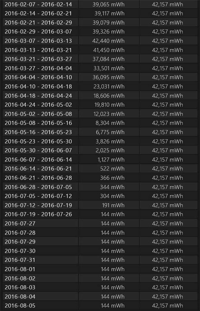

I've been using Microsoft Surface Pro 3 for a year, and shortly after the warranty expired I noticed my Surface Pro 3 can only last about 1-2 hours after a full charge. At first I thought this was a problem with background process draining the battery so I disabled everything running in the background. It didn't helped. Then I found out about the powercfg utility and run powercfg /batteryreport on it, and this was the result:
A full charge capacity has degraded by over 80% in just few weeks and continue degrading. I tried to "recalibrate" the battery by doing full charge then full drain multiple times, and it didn't helped. Talk with Microsoft via chat support and they insist this was a software problem and reinstalled the driver and asked me to wait few days to see if things improve. Not only it didn't improved, but now my Surface can only last 30 minutes.

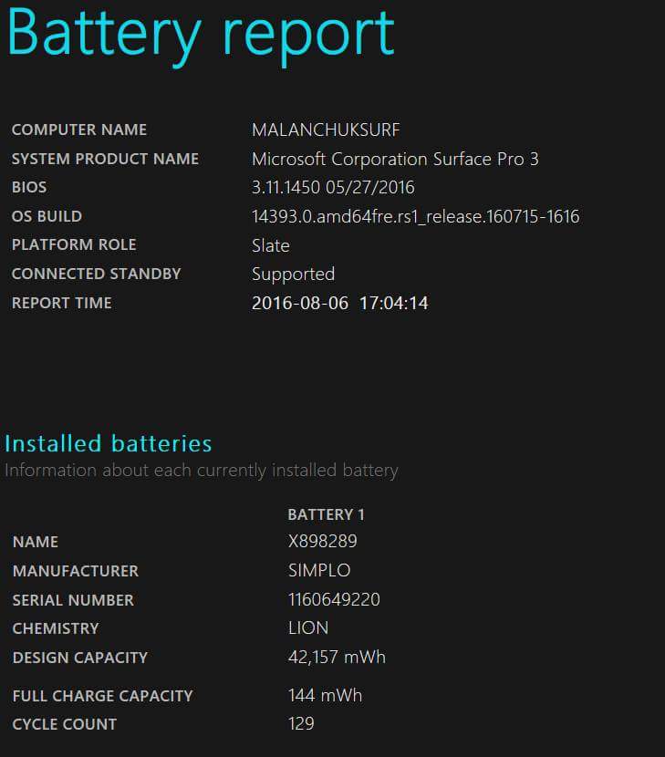

    My LGC LGC reports over 40000 mWh after 73 cycles. However in practice it works only for 1.5 - 2 hours, while I only use a spreadsheet and some Internet. That is pretty bad because I didn't use the Surface often. That is the reason I searched Internet and found this forum.

    okay. so does this means that the reported over 40,000 mWh doesn't really mean anything since it's just a number and it won't last long as well? that will worry us even more. but in some SIMPLO batteries it's probably just an indicative as some when it goes down to 400 mWh only, it just can last few minutes which some users reported that happen.
    73 cycles are really pretty bad to get such a low usage....

    I have the same problem on my Surface Pro 3 with an LGC-LGC battery. Degradation started in June 2016. The full charge capacity is now 14,387 mWh against ~41,000 mWh in early June and ~22,000 mWh a week ago.
