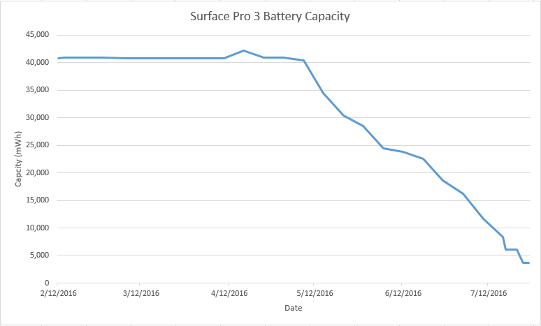

    2016-07-27T23:12:12+00:00
    Adding my name to the ever-growing list of people having the same issue.
    Here's my particular favorite from the battery report:
    2016-07-2716:50:43 Connected standby Battery 100 % 3,656 mWh
    16:50:43 Suspended 100 % 3,656 mWh
    16:59:38 Active AC 2 % 46 mWh
    100% to 2% in just under 9 minutes.
    I don't know how this is at all acceptable. I usually expect much better from Microsoft products. This should really be considered a top priority issue due to the number of people experiencing it and the impact (basically makes the device unusable).
    2016-02-01 - 2016-02-12 40,806 mWh 42,157 mWh
    2016-02-12 - 2016-02-14 40,880 mWh 42,157 mWh
    2016-02-14 - 2016-02-21 40,880 mWh 42,157 mWh
    2016-02-21 - 2016-02-28 40,880 mWh 42,157 mWh
    2016-02-28 - 2016-03-07 40,871 mWh 42,157 mWh
    2016-03-07 - 2016-03-13 40,857 mWh 42,157 mWh
    2016-03-13 - 2016-04-10 40,822 mWh 42,157 mWh
    2016-04-10 - 2016-04-17 42,235 mWh 42,157 mWh
    2016-04-17 - 2016-04-24 40,896 mWh 42,157 mWh
    2016-04-24 - 2016-05-01 40,896 mWh 42,157 mWh
    2016-05-01 - 2016-05-08 40,472 mWh 42,157 mWh
    2016-05-08 - 2016-05-15 34,526 mWh 42,157 mWh
    2016-05-15 - 2016-05-22 30,370 mWh 42,157 mWh
    2016-05-22 - 2016-05-29 28,568 mWh 42,157 mWh
    2016-05-29 - 2016-06-05 24,444 mWh 42,157 mWh
    2016-06-05 - 2016-06-12 23,868 mWh 42,157 mWh
    2016-06-12 - 2016-06-19 22,534 mWh 42,157 mWh
    2016-06-19 - 2016-06-26 18,674 mWh 42,157 mWh
    2016-06-26 - 2016-07-03 16,251 mWh 42,157 mWh
    2016-07-03 - 2016-07-10 11,709 mWh 42,157 mWh
    2016-07-10 - 2016-07-17 8,456 mWh 42,157 mWh
    2016-07-18 6,110 mWh 42,157 mWh
    2016-07-19 6,110 mWh 42,157 mWh
    2016-07-20 6,110 mWh 42,157 mWh
    2016-07-21 6,110 mWh 42,157 mWh
    2016-07-22 6,110 mWh 42,157 mWh
    2016-07-23 4,746 mWh 42,157 mWh
    2016-07-24 3,656 mWh 42,157 mWh
    2016-07-25 3,656 mWh 42,157 mWh
    2016-07-26 3,656 mWh 42,157 mWh
    NAME X898289
    MANUFACTURER SIMPLO
    SERIAL NUMBER 1162156548
    CHEMISTRY LION
    DESIGN CAPACITY 42,157 mWh
    FULL CHARGE CAPACITY 1,968 mWh
    CYCLE COUNT 136
    Here's a helpful graph for anyone who thinks this is "normal lithium ion degradation"
