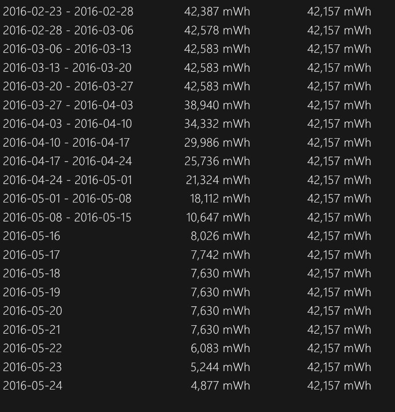

I've been using Microsoft Surface Pro 3 for a year, and shortly after the warranty expired I noticed my Surface Pro 3 can only last about 1-2 hours after a full charge. At first I thought this was a problem with background process draining the battery so I disabled everything running in the background. It didn't helped. Then I found out about the powercfg utility and run powercfg /batteryreport on it, and this was the result:
A full charge capacity has degraded by over 80% in just few weeks and continue degrading. I tried to "recalibrate" the battery by doing full charge then full drain multiple times, and it didn't helped. Talk with Microsoft via chat support and they insist this was a software problem and reinstalled the driver and asked me to wait few days to see if things improve. Not only it didn't improved, but now my Surface can only last 30 minutes.
Few days after chat (today), I called Microsoft support and they were being extremely unhelpful. Insist that this was a software problem (which the chat support person already did) and it's "perfectly normal" for battery capacity to degrade. I insist that I've already done the software "fixes" and it didn't work and tell them this is definitely hardware problem, but the person on the phone tell me there's nothing I could do except to order the out of warranty exchange (which cost about $560 in my local currency).

    My battery power looks like this:
    DESIGN CAPACITY 42,157 mWh
    FULL CHARGE CAPACITY 274 mWh
    I can keep it running as a desktop computer when it doesn't say 'not charging'. I can also run it on my portable DC battery pack.
    I have a feeling that when the battery report finally reads 0 mWh it will not run at all because it will need some battery to complete the circuitry, is that correct?

    I'm also having this issue with my Surface Pro 3.  The battery no longer holds a charge and to replace the battery, MS is asking for $450.00 for a device that is about two years old.
    It was suggested that the battery drain might be a software issue and an update or patch could apply.  Is there any validity for this suggestion?
    Here is a copy my Surface Pro 3 battery report.
    Thank you for your anticipated assistance.

    Greg/MSFT... Add me to the list. Here's my battery report
    Battery report
    COMPUTER NAME XXXXXXXXXXXXXXXX
    SYSTEM PRODUCT NAME Microsoft Corporation Surface Pro 3
    BIOS 3.11.1450 05/27/2016
    OS BUILD 14393.0.amd64fre.rs1_release.160715-1616
    PLATFORM ROLE Slate
    CONNECTED STANDBY Supported
    REPORT TIME 2016-08-01 11:47:48
    Installed batteries
    Information about each currently installed battery
    NAME X898289
    MANUFACTURER SIMPLO
    SERIAL NUMBER 1163401732
    CHEMISTRY LION
    FULL CHARGE CAPACITY 1,178 mWh
    CYCLE COUNT 145
    Recent usage
    Power states over the last 3 days
    2016-07-29 12:10:00 Active AC 100 % 1,246 mWh
    13:00:22 Connected standby AC 100 % 1,246 mWh
    13:00:28 Connected standby Battery 100 % 1,246 mWh
    13:00:29 Active Battery 100 % 1,246 mWh
    13:00:34 Connected standby Battery 95 % 1,186 mWh
    13:02:29 Connected standby AC 90 % 1,125 mWh
    13:02:29 Active AC 90 % 1,125 mWh
    13:02:35 Connected standby AC 90 % 1,125 mWh
    13:02:45 Active AC 91 % 1,132 mWh
    14:14:00 Suspended 100 % 1,246 mWh
    2016-07-31 21:22:34 Active AC 100 % 1,178 mWh
    23:11:18 Connected standby AC 100 % 1,178 mWh
    23:23:00 Suspended 100 % 1,178 mWh
    2016-08-01 10:17:57 Active AC 95 % 1,117 mWh
    11:45:00 Report generated AC 100 % 1,178 mWh
    Battery usage
    Battery drains over the last 3 days
    2016-07-29 13:00:28 Connected standby 0:00:00 - -
    13:00:29 Active 0:00:05 5 % 60 mWh
    13:00:34 Connected standby 0:01:54 5 % 61 mWh
    Usage history
    History of system usage on AC and battery
    2016-06-10 - 2016-06-17 6:46:33 23:21:42 17:16:41 23:09:30
    2016-06-17 - 2016-06-24 4:02:48 18:22:42 40:29:00 24:22:18
    2016-06-24 - 2016-07-01 5:16:50 25:24:11 35:00:44 58:45:14
    2016-07-01 - 2016-07-08 1:38:33 9:26:34 34:52:45 95:51:39
    2016-07-08 - 2016-07-15 2:47:49 7:56:29 36:50:56 16:58:15
    2016-07-15 - 2016-07-22 2:27:47 6:37:26 48:58:52 22:14:04
    2016-07-23 - - 10:06:51 13:25:49
    2016-07-24 - - - -
    2016-07-25 0:01:24 0:30:26 6:43:54 0:57:53
    2016-07-26 0:01:35 0:08:30 10:04:52 0:18:07
    2016-07-27 0:00:03 0:00:03 7:58:47 0:16:00
    2016-07-28 0:01:53 1:18:37 8:18:05 0:04:47
    2016-07-29 0:00:05 0:01:52 4:49:13 0:10:42
    2016-07-30 - - - -
    2016-07-31 - - 1:48:43 0:11:41
    Battery capacity history
    Charge capacity history of the system's batteries
    2016-06-10 - 2016-06-17 21,896 mWh 42,157 mWh
    2016-06-17 - 2016-06-24 18,559 mWh 42,157 mWh
    2016-06-24 - 2016-07-01 14,273 mWh 42,157 mWh
    2016-07-01 - 2016-07-08 10,552 mWh 42,157 mWh
    2016-07-08 - 2016-07-15 7,459 mWh 42,157 mWh
    2016-07-15 - 2016-07-22 4,824 mWh 42,157 mWh
    2016-07-23 2,804 mWh 42,157 mWh
    2016-07-24 2,804 mWh 42,157 mWh
    2016-07-25 2,367 mWh 42,157 mWh
    2016-07-26 1,884 mWh 42,157 mWh
    2016-07-27 1,486 mWh 42,157 mWh
    2016-07-28 1,426 mWh 42,157 mWh
    2016-07-29 1,304 mWh 42,157 mWh
    2016-07-30 1,246 mWh 42,157 mWh
    2016-07-31 1,238 mWh 42,157 mWh
    Battery life estimates
    Battery life estimates based on observed drains
    2016-06-10 - 2016-06-17 3:00:15 40:48:51<br><br>39 % / 16 h 5:47:03 78:34:52<br><br>20 % / 16 h
    2016-06-17 - 2016-06-24 2:23:29 49:52:23<br><br>32 % / 16 h 5:25:55 113:17:16<br><br>14 % / 16 h
    2016-06-24 - 2016-07-01 2:01:34 35:57:59<br><br>44 % / 16 h 5:59:03 106:13:52<br><br>15 % / 16 h
    2016-07-01 - 2016-07-08 0:55:59 18:58:31<br><br>84 % / 16 h 3:43:41 75:48:36<br><br>21 % / 16 h
    2016-07-08 - 2016-07-15 0:54:01 16:26:41<br><br>97 % / 16 h 5:05:22 92:56:39<br><br>17 % / 16 h
    2016-07-15 - 2016-07-22 0:31:52 7:17:13<br><br>220 % / 16 h 4:38:36 63:40:53<br><br>25 % / 16 h
    2016-07-23 - - - -
    2016-07-24 - - - -
    2016-07-25 0:04:41 0:57:29<br><br>1670 % / 16 h 1:23:28 17:03:55<br><br>94 % / 16 h
    2016-07-26 0:04:27 0:11:27<br><br>8384 % / 16 h 1:39:55 4:16:19<br><br>375 % / 16 h
    2016-07-27 0:00:24 0:01:04<br><br>90000 % / 16 h 0:11:34 0:30:32<br><br>3144 % / 16 h
    2016-07-28 0:04:31 1:50:59<br><br>865 % / 16 h 2:13:53 54:41:25<br><br>29 % / 16 h
    2016-07-29 0:01:48 0:39:54<br><br>2406 % / 16 h 0:58:33 21:30:03<br><br>74 % / 16 h
    2016-07-30 - - - -
    2016-07-31 - - - -
    Current estimate of battery life based on all observed drains since OS install
    Since OS install 0:08:51 2:21:37<br><br>678 % / 16 h 5:16:53 84:28:32<br><br>19 % / 16 h
