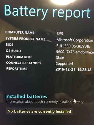

    So frustrated.  I can't install the latest update, because the battery is no longer detected.  I have tried a refresh, re-image, Windows 10 install, the three finger salute and nothing works.
