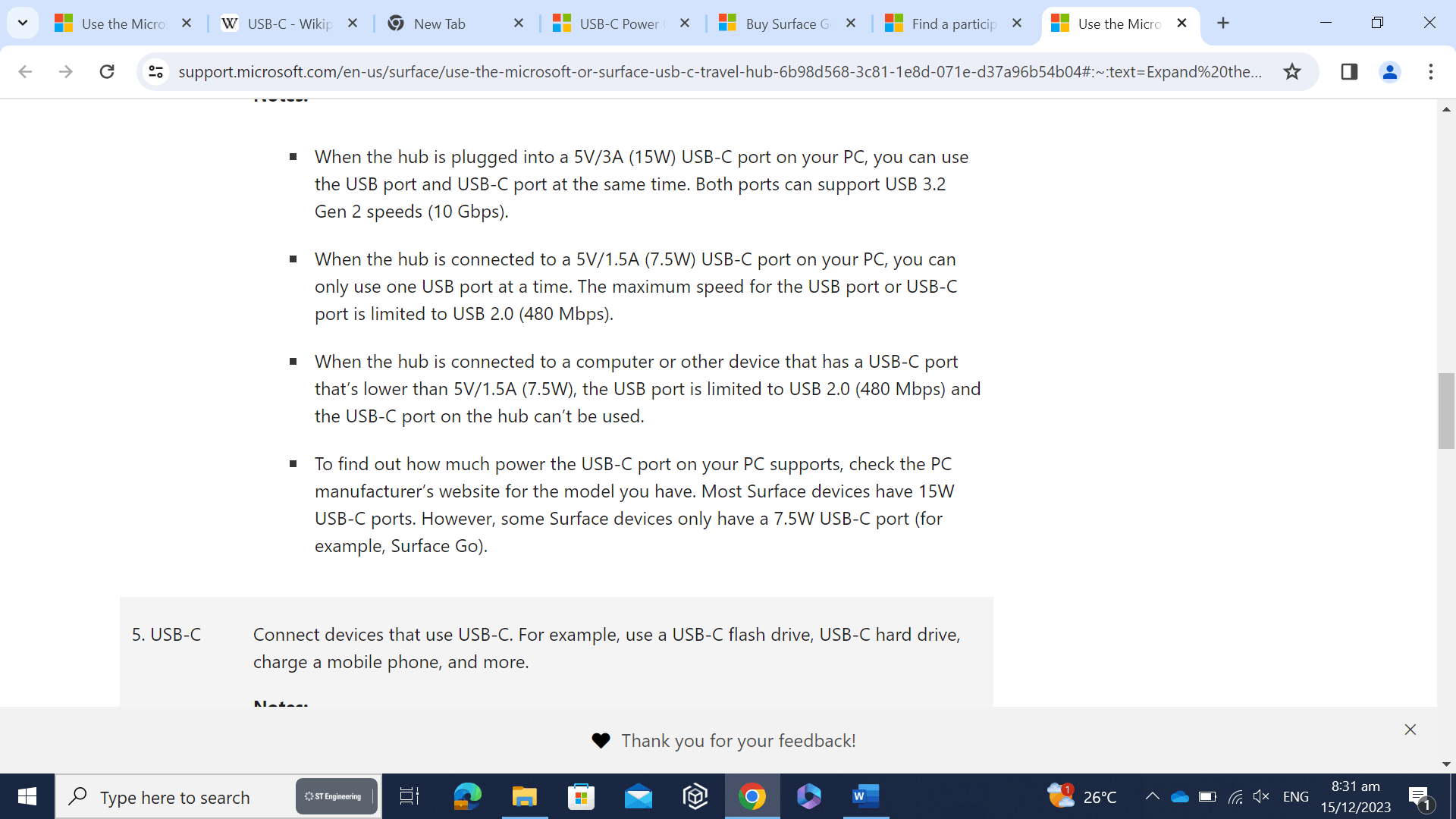

    Hi RodelioP
    Is it that Surface Go 3 can only support 7.5W drawn from its USB-C port ?
    If Surface Go 3's USB-C port can only support power output of 7.5W, does it mean when a USB-C hub with mulitple USB-A connection to external USB devices is connected , according point 2, only one external USB-A device will work at any one time, would like to some elaboration on this. What does this mean. Thanks
