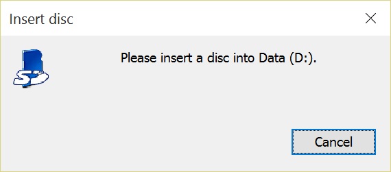

    The problem I get is that when it is in the surface 3 micro sd slot it disconnects ANY time I put it under load, i.e. install games to it, try to run crystal disk on it etc. The annoying thing is if I use a USB 3 sd card adapter with the surface 3 I get no issues at all. I've tried formatting it as NTFS and exFat, both seemed to perform the same way, and I get this error:
    I know it's not a physical connection issue because the card is there on restart, but it will disconnect if I try to put it under load again. I've tried disabling/uninstalling the drive to repair it in device manager but with no luck, same with enabling write caching. It also seems to suffer much worse read speeds when I put it in the sd card slot, 40MB per sec reads in the micro sd slot versus 70+ in the USB3 adapter.
    Does anybody else have similar issues? It feels very much like the sd card slot on my surface 3 is broken and it's less than 2 weeks old :(
