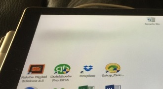

I purchased SP4 device a few months ago and it was working fine for a month. Then I noticed that when the CPU is at its max, the screen flickers a bit. Investigating further revealed that it flickers even if it is setting idle. It does not flicker if at least one of the following thing is done:
  1. A video being played in browser
  2. If I keep the touch screen busy by either taping it or keeping a finger on it
  3. If I use the touchpad
  4. If keyboard is used for typing
This resulted in making the device completely unusable while reading articles or ebooks. I am a developer, most of the time I have to read the code and to do that, I have to constantly keep a finger on the touch pad or the screen. I contacted surface support in October and November and was told that the developers are working on the patch. Looking at the updates the developers are pushing since then, I don't think anyone is even aware of the problem there.

    Does anyone else have a dark smudge on your display in the area where the flickering is the worst?
    I finally contacted Microsoft after months of research and attempting to fix this problem myself. They responded that it is a defective unit and want $450 for a replacement. I told them "no thank you" because the replacement will likely have the same issue. I also told the technician to read this thread and that they need to do a full recall/replacement of these defective units.
    I contacted the company I purchased it from and told them I want to return this piece of junk to them for a full refund. I doubt they will give it to me though since they keep referring me to Microsoft.
    Adding the seconds to the clock is helping for now, but that does not address the issue of Microsoft selling defective SP4s. In addition to the flickering, I'm having the fan/heat issues as well.
