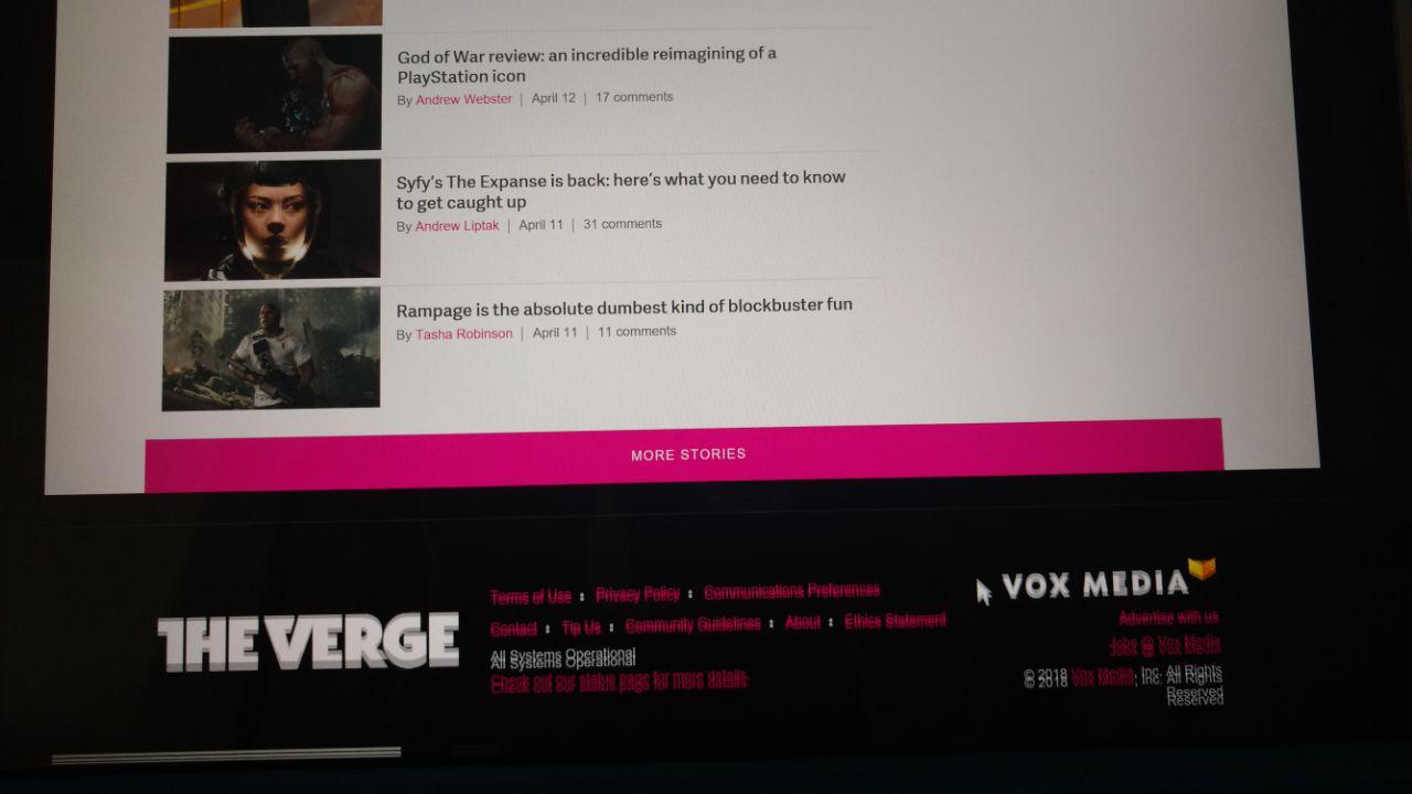

    Hi guys,
    How can I solve this problem? (please consider pictures below)
    I had flickering issue related to my surface pro 4, but annoying flickering that I encountered had been solved. The new problem is that bottom of screen isn't calibrated truly.
    I would greatly appreciate it if you kindly give me some helpful advice.
    TNX.
