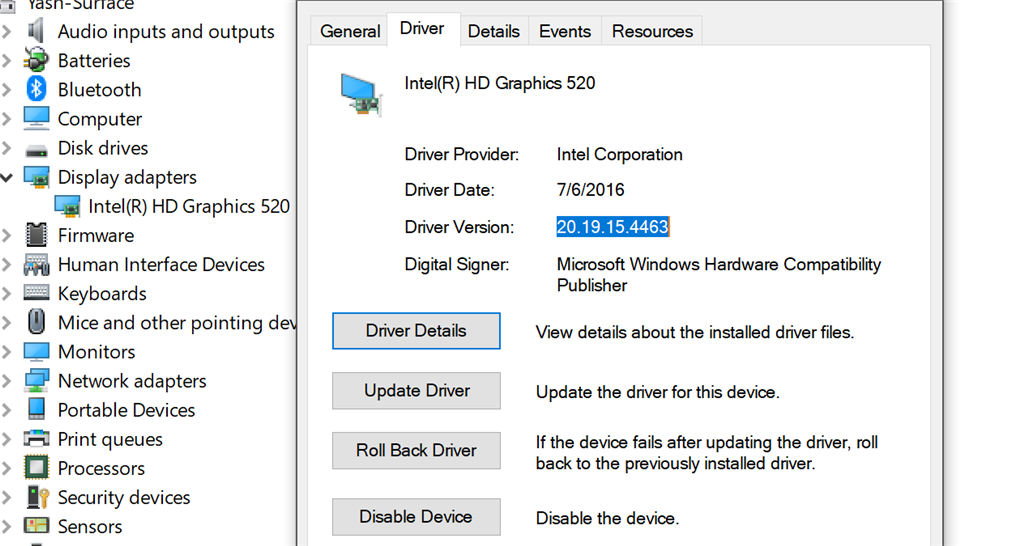

    2017-12-05T02:47:36+00:00
    If your driver version is greater than 20.19.15.4463
    Try this:
    1.
    Intel(R) Graphics Driver: 20.19.15.4463
    Download zip: https://1drv.ms/u/s!AiE1VFHYXP0E5\_kHlToDX38iSoDoIw and extract
    Update Driver > Browse my computer > Let me pick > Have Disk
    Point to 64gh4463.inf
    Let it install.
    2.
    Intel(R) Graphics Driver: 20.19.15.4352
    https://downloadcenter.intel.com/download/25620/Intel-Graphics-Driver-for-Windows-7-8-1-10-15-40-6th-Gen-?product=88355
    Download the zip and follow per 1. steps and look for "igdlh64.inf"
    It appears that there could be some kind of regression in drivers.
    Disclaimer : I got the driver from microsoft employee, you can run some scans if you are being cautious, but trust me it has nothing bad :) Posting something here until microsoft officially does something, it's a pain to see lot of users complaining about it with no official acknowledgement of the issue. I roll backed using the same procedure, it apparently helped some folks, but this #1 or #2 DID NOT work for me. Posting just in case if it helps anyone.
