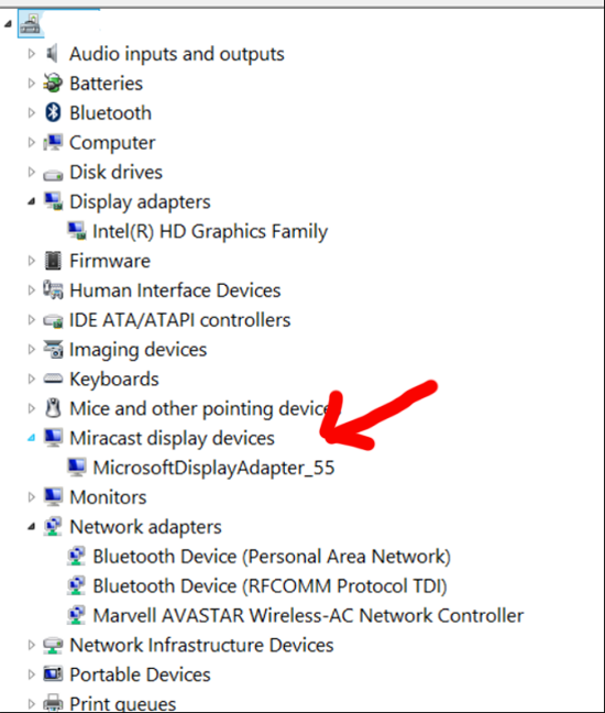

Here's how I fixed the problem without a system reset.
  1. Go into Device Manager and from View make sure show hidden devices s selected.
  2. There should now be an item that has an exclamation point. Remove it and all of the devices with the same name followed by #1 #2 etc if there are any.  I'm sorry that I didn't make a note of what it was and I can't remember. But if this is your problem, it will be there. Make sure to uninstall all of the same named devices.
  3. Restart. Do not rescan. I tried that and it didn't work. I had to restart to make it work.
  4. After a restart I slide in from the right side and selected Devices from Charms. I selected project and the Add a Wireless Display was back. I tapped it and it found the MS Wireless Display Adapter. I connected and it worked fine.

    2015-03-17T21:45:32+00:00
    thanks for your feedback. But where can i find the miracast device in the device manager?
    Î have no entry for the miracast in the device manager - comes this device via the windows update or by the first sucessfull connect with the wireless display adapter?
    You need to go to view-show hidden devices
