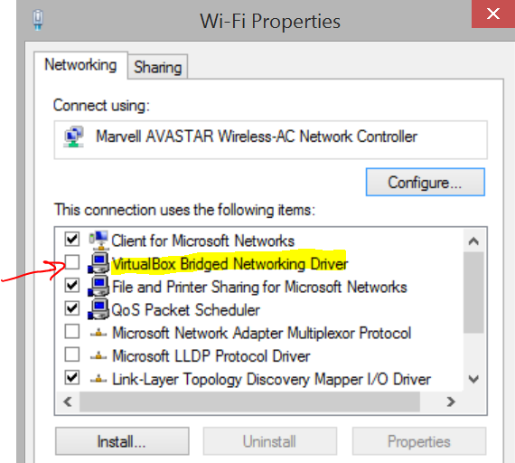

    1. Virtualization software like VirtualBox
    I'm glad I found this thread.  In my case I had VirtualBox recently installed by a program called Andy (an Android emulator).  After I bit more research I found another site that pointed out the solution I needed.  It said to uncheck the Networking driver for VirtualBox in the properties of my network adapter.  Once I did that, I could again see the "Add a wireless display" option in the Devices-Project section of the Charms bar.
