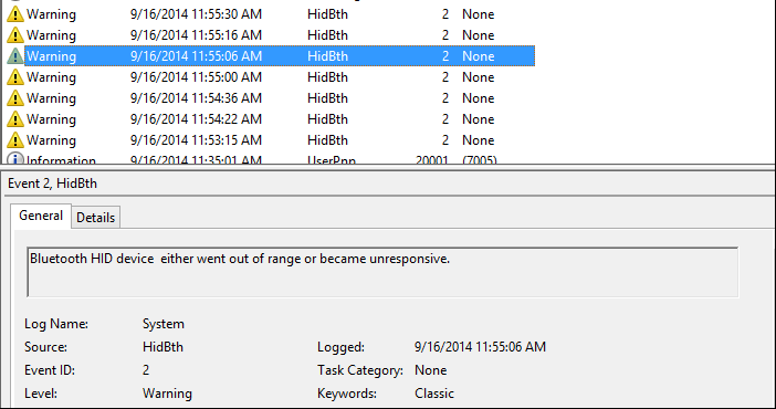

Prior to this firmware update I was able to use my Logitech K810 without issue with my Surface Pro 3. However, now it just goes into a connect/reconnect loop. I'll see "driver error" briefly. And then it'll try connecting again.
Looking into the event log for Administrative events, I see this:
Bluetooth HID device  either went out of range or became unresponsive.
I also see another event within seconds that says this:
Metadata staging failed, result={66F5F5A4-2104-53C0-BCDF-9DD1AF9AE33F} for container '0x80070490'
All of this appears to be an issue with the driver and/or firmware.
Furthermore, the keyboard works when pairing (typing in the keycode), but immediately after pairing it fails. So there is certainly something wrong and I don't believe it's the keyboard.

    That might be my fault.  I completely uninstalled the Bluetooth driver and let Windows update reinstall it.    On other forums I've heard of other people having the same issues with Surface Pro 3 and Logitech K810 keyboards and the latest firmware updates.   I'm not eager to roll my whole machine back since I haven't had good luck with the process.  I found the following error messages in the event logs:
