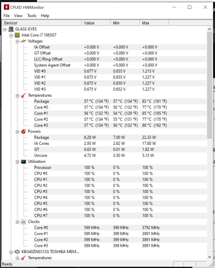

My 2 week old surface book 3 ( i7-1065G7) is now throttling at a very low speed of .19GHz.
I have a standard mouse plugged in, and a Microsoft USB-C Travel hub connected.  To the travel hub, i have a 2nd monitor connected via VGA cable.  This system worked well until i plugged in an Ethernet cable to the hub from my router.
I have unplugged the travel hub, and have restarted the computer 2 times now with no luck.

    I have updated the iGPU graphics, Wifi and BT with the latest version and today I managed to be around 3h on a Zoom VC sharing screens and receiving shared screens, Chrome, WhatsApp and Music open. There was no throttling at all and it has been running very smooth. Before the update, while doing the same thing, it was throttling down to 599Mhz. Therefore, probably the recommendation from Christoph I think it's  a step forward on making the SB3 "great again".
