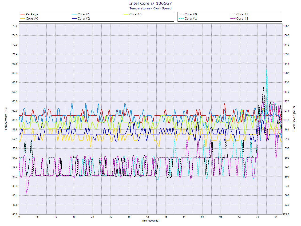

My 2 week old surface book 3 ( i7-1065G7) is now throttling at a very low speed of .19GHz.
I have a standard mouse plugged in, and a Microsoft USB-C Travel hub connected.  To the travel hub, i have a 2nd monitor connected via VGA cable.  This system worked well until i plugged in an Ethernet cable to the hub from my router.
I have unplugged the travel hub, and have restarted the computer 2 times now with no luck.
