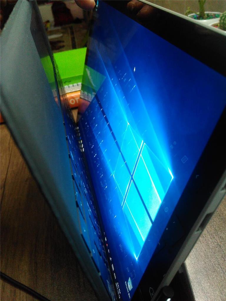

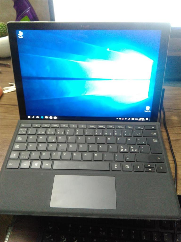

    hi
    my type cover dosent work while i put it correct on the table
    but when i put cover near to screen it work or when i rotate it to top
    i try any solotion , clean install windows re-install drivers and...
    problem still here(sad)
    the type cover have any sensor like proximity or something else?
    surface without type cover is damn wooden PC
    im in afghanistan and i dont gave access to microsoft store
    what can i do?!(sad)
