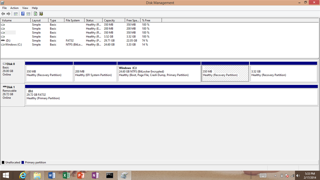

Greetings all,

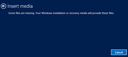

When trying to reset or refresh my Surface RT, I receive the following error:
Could not find the files needed
If you have a Windows installation or recovery media, insert it and restart the PC from the media.
Obviously, the Surface RT comes with no such media, so I'm unsure what to do.  I think there was a way to fix this error on Windows 8 by moving the install.wim file over and doing some command line entries, but given I can't find an install.wim for RT, that is kind of not possible.
I can confirm that per Disk Management, the recovery partition is there, as is the EFI partition and the main Windows partition.
-Justin

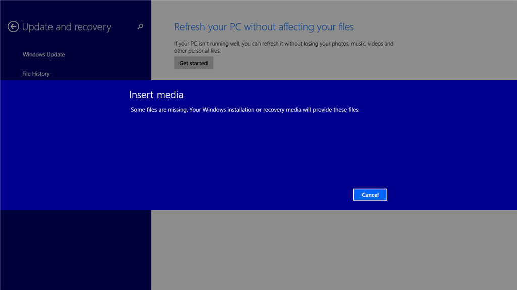

2014-10-02T21:23:49+00:00
Hi Dusty,
Thank you very much for reaching out to the Surface Community. I'm very sorry to hear that you are unable to perform a refresh. I understand that you need the device for school, and I will try my best to get this issue resolved as soon as possible.
To confirm that I understand what you have tried correctly, you have tried the steps below, PC settings disappears and shows the "Unable to Recovery..." error message appears?:
Step 1: Plug in your Surface so that you don’t run out of power during the refresh.
Step 2: Swipe in from the right edge of the screen, tap Settings
(If you're using a mouse, point to the upper-right corner of the screen, move the mouse pointer down, click Settings.)
Step 3: Tap or click Change PC settings.
Step 4: Tap or click Update and recovery, and then tap or click Recovery.
Step 5: Under Refresh your PC without affecting your files, tap or click Get started.
Step 6: Tap or click Next, ensure that your Surface is plugged in, and tap or click Refresh.
Step 7: Surface restarts and the Surface logo displays while the refresh process completes.
(This can take several minutes.)
If these are the steps that you have tried and it won't let you refresh the device, I would suggest performing a refresh using USB recovery media. Here's how:
Step 1: Shutdown Surface and plug it in so that you don’t run out of power during the refresh.
Step 2: Insert the USB recovery drive into the USB port.
Step 3: Press and hold the volume-down button while you press and release the power button.
Step 4: When the Surface logo appears, release the volume-down button.
Step 5: When prompted, select the language and keyboard layout you want.
Step 6: Tap or click Troubleshoot, tap or click Refresh your PC, and then tap or click the target operating system you wish to refresh.
Step 7: On the Refresh your PC screen, tap or click Next, and then tap or click Refresh.
Step 8: Surface restarts and the Surface logo displays while the refresh process completes.
You can obtain the recovery media for the Surface RT from this site.
Please let me know refreshing from USB helped.

The good news is that there are recovery images available for download for Surface RT Here.
Keep in mind that these images are of Windows 8.0 RT, and you will have to apply all updates, install the 8.1 update, then the following updates.
After creating the Recovery USB, you can find directions on using it Here.

2013-12-16T05:49:09+00:00
Open the Charms bar and click Settings> Change PC settings> Update and recovery> Recovery> Remove everything and reinstall Windows.
2013-11-20T20:49:55+00:00
I went through the RT 8.1 upgrade again and refresh/restore does seem to be working correctly now.
I remember removing the old version of Windows using the cleanup app the last time I upgraded to RT 8.1 to free up some space. Does removing the "old" Windows RT 8 folder cause the media error to appear? Surely the recovery partition is all you need for refresh/restore rather than having a copy of the previous OS stored on the Surface.

2013-11-04T00:14:12+00:00
You can try to copy/paste the image from the USB pendrive onto another to have a backup of it.  Microsoft had before made available image files for people in the past and that seemed to work.
If your tablet still has the recovery partition, it will be empty and leave it alone!!!  REMEMBER, I said to leave the partitions alone.  Reason being is that if Windows 8.2 ever is made or Windows 9, that new installation will create a new image file and it needs somewhere to create it.  I think you can see the picture of that now.  No partition, no recovery image.
If you go to "This PC" and look at Drive C:, before you moved the image off of the tablet, you had about 48% free space.  After you moved the image file off of the tablet, you should have a lot more free space available on Drive C:.  The system should have readjusted the partition sizes to give you more space.
All in all, you have moved the image off the tablet, you should now have more free space for Drive C: and if you need more storage, just plug in a micro-SD card.  You have a potential unlimited storage by that method.  On my RT, I have all of my files on a micro-SD card (documents, pictures, music, and videos) and have no files on the tablet itself.  No problem.  The Xbox video, music, and pictures apps will read from the micro-SD card.  You have to wait a few minutes after the app first loads and then you will see it populate with your files.
In the future and if you get a new tablet, leave the image file alone and leave it on the tablet.  Again, you can always add more storage with micro-SD cards.  With a handful of those things, you could store the entire Library of Congress and eat up no space on the tablet itself.
Never, ever tinker with the file structure of the RT class tablets.  You could end up with an expensive lump of aluminum and glass that could be dead as a rock.  That is also not covered by the warranty!
2013-11-02T02:52:50+00:00
Thanks for your answers, I finally pointed out was going wrong and why 8.1 update did not registered my recovery partition.
I installed the 8.1 preview when it was release. Before updating to 8.1, I did a factory reset using the pen drive I had created with windows 8 RT.
as I was installing windows 8, I probably did not select the re-partitioning option at the time, which means the recovery partition kept the 8.1 preview image and not the 8.1 image.
I reset the surface using the iso downloaded on line and updated to 8.1, it created this time a 8.1 recovery partition and I was able to reset the tablet to factory default with 8.1.
