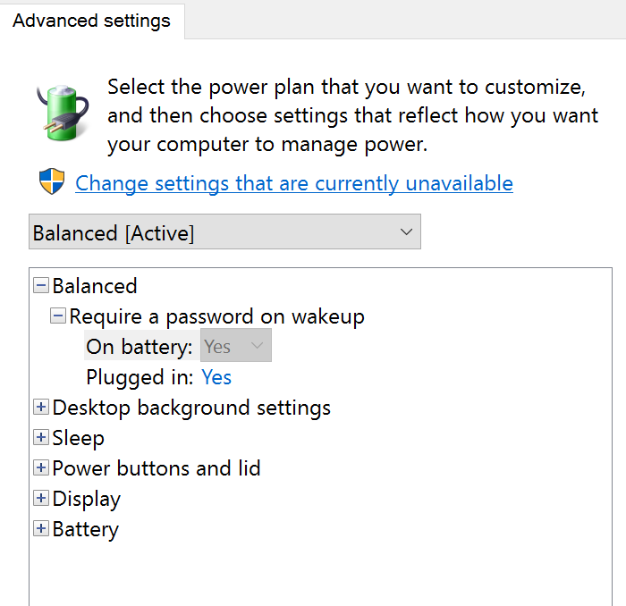

    If Connected Standby is correctly turned off, you'll see a lot more options. After you made the reg change, I'm assuming you rebooted?
    2015-11-23T13:41:28+00:00
    Of course. Maybe it didn't truly turn off. :-\
