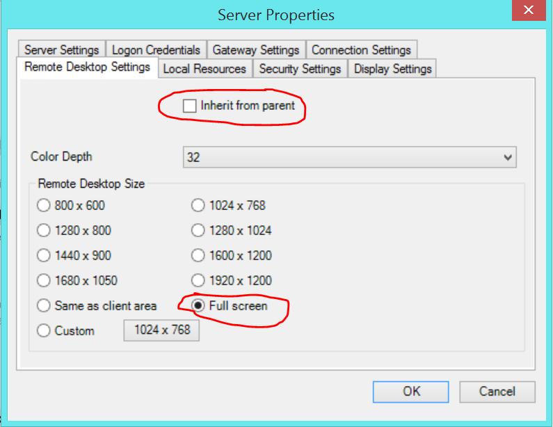

    2014-12-27T01:39:38+00:00
    Thanks for the tip Frank, using the Remote Desktop connection manager v 2.2 fixed my problem!
    I am now connected to my work PC with the perfect scaling and resolution.  I tweaked the settings a bit differently and got great results using the RDP Manager v2.2.  I ended up leaving the "Display Settings" tab alone (inherit from parent checked) but change some settings on the "remote desktop setting tab."
    I unchecked Inherit from parent and then below I chose Full screen.
    Works like a charm.
    Regards,
    Dubois
