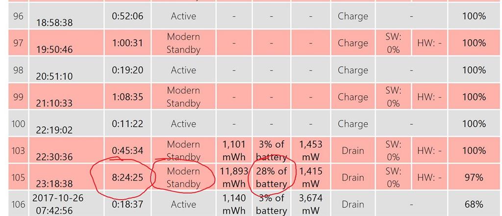

    Just in case, since we can't see your sleep study report, this is what mine looks like.
    Prior to the Fall Creator's Build upgrade, my system (not a Surface) would doze to hibernation.  Now it just uses power when in a drawer.  I have started shutting mine down using a command from the command prompt.
