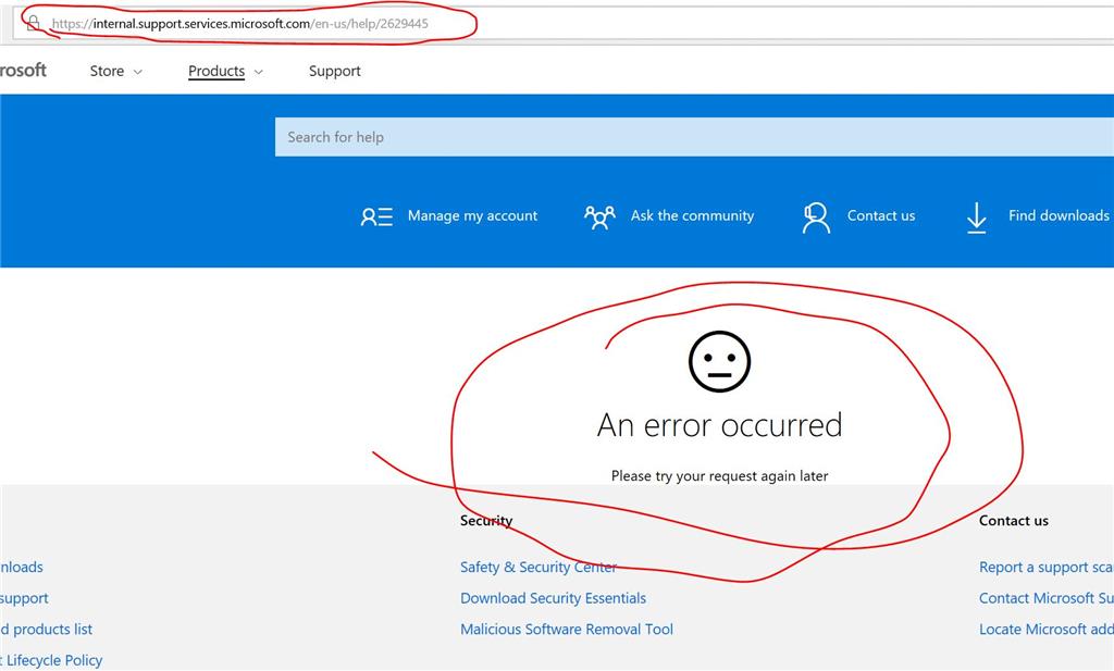

    2017-12-22T18:37:12+00:00
     screen shot of the error you encounter with the link we provided?
    In my case a more accurate description than "error" would be that I don't have an account which satisfies this login
    https://login.microsoftonline.com/common/login
    What does it want?  Why does the original link want to take me there?
    I definitely have a lookup for the original host name.
    PS>nslookup internal.support.services.microsoft.com
    Server:  UnKnown
    Address:  192.168.1.1
    Non-authoritative answer:
    Addresses:  2600:140a:0:19e::f03
              2600:140a:0:1a4::f03
              96.16.46.29
    Aliases:  internal.support.services.microsoft.com
              internal.support.services.microsoft.com.edgekey.net
