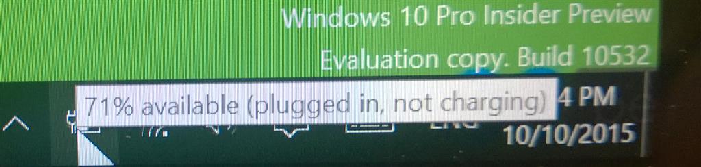

    Here are the various charging behaviors that happen as I plug my Surface 3 to the charger when the battery is not full:
    • It shows “Plugged in, not charging”. The battery continues to drop.
    • It starts to charge. However, charging stopped after a while showing “Plugged in, not charging”.
    • Only in a few cases, my Surface 3 was charging without problem.

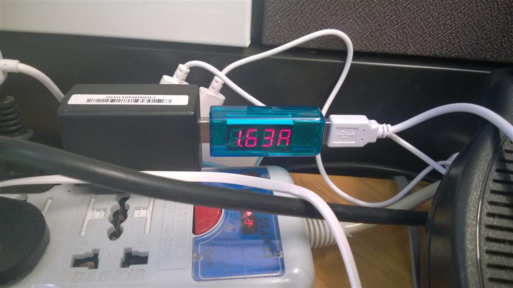

    I used a USB Power Meter to test this. It couldn't detect the charging power at Surface 3 but could detect that at the charger. Please note that the charger I used was not the one that comes with Surface 3 but the one for my Lenovo pad.

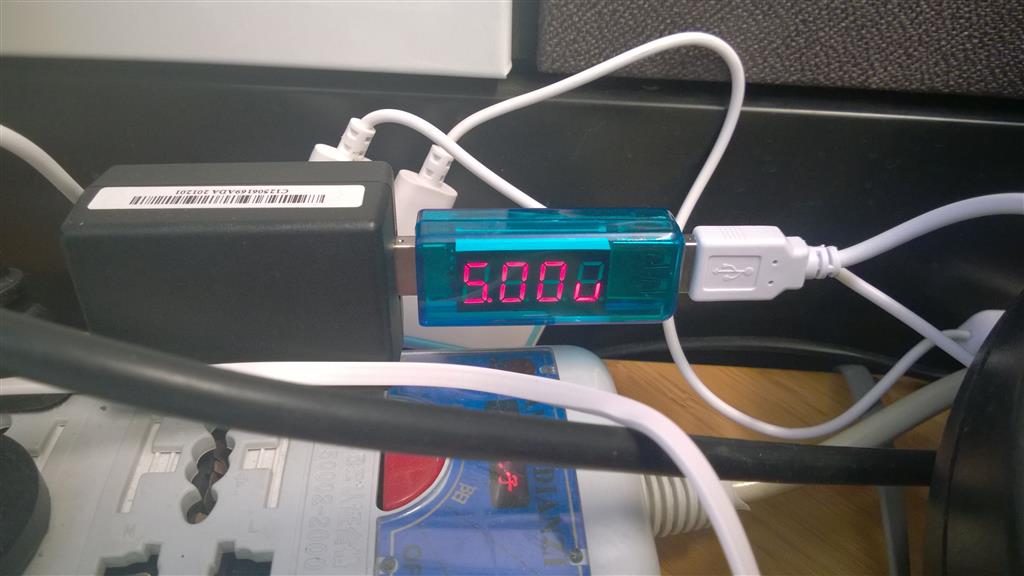

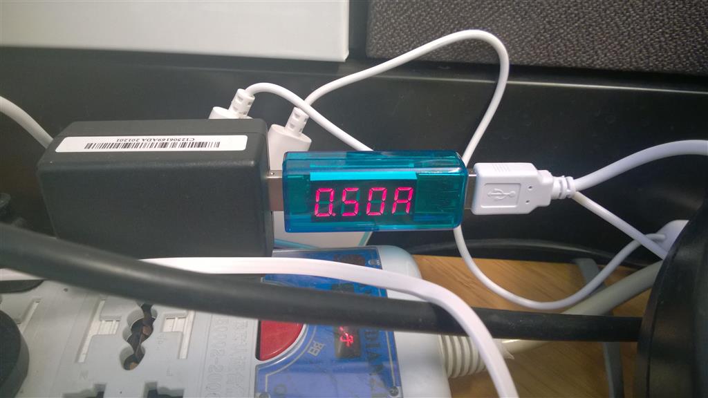

    Test 1
    The battery was at 71% and the charging issue occurs. The USB Power Meter showed the output power is at 5V|0.5A. You see the problem?

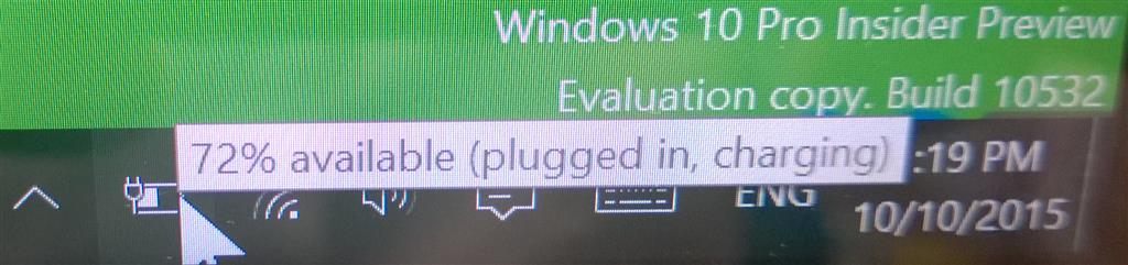

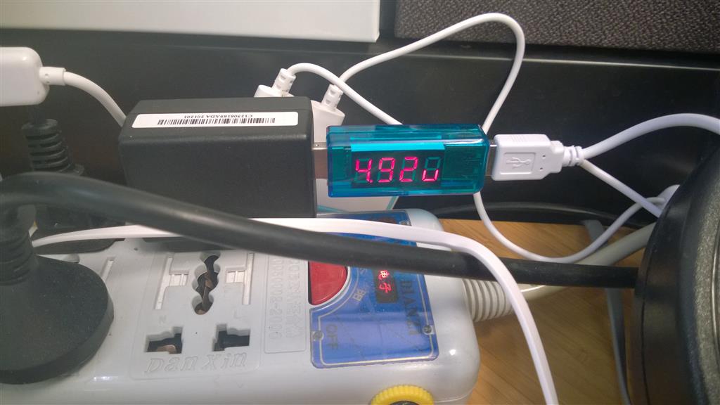

    Test 2
    In test 1, I unplugged and re-plugged in several times until the charge worked. The battery was at 72%, the meter showed 4.92V|1.63A.

    The charger doesn’t respond/provide the charging power that Surface 3 needs. The gap causes the charging issue. Even in Test 2, the charging was not at full capacity of the charger.

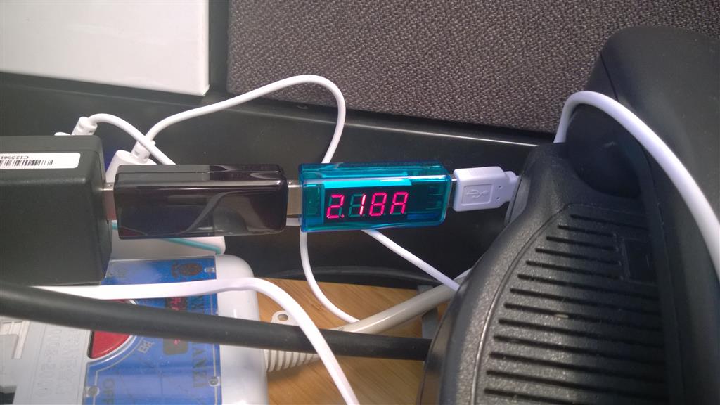

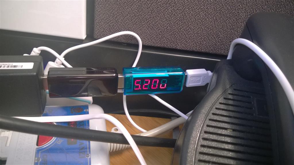

    I used the second solution. The tool I used was a USB voltage booster.
    The result was that the charging issue never comes back. Additionally, the charging power was stronger, at 5.2V|2.18A, than before, resulting a speedy charge. The golden rule is the stronger the safe charging current is, the faster the charging is.
