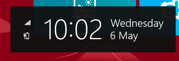

After getting my Surface 3 yesterday, I plugged it in as it was delivered with about 24% batter life.  The little white light on the micro-USB charger than comes with the Surface lit up.  I assumed all was well, and started the Windows Updates.  It was taking a while so I left it and went to bed.
The next morning the Surface was off, and when I tried to switch it on the battery symbol appeared that indicates it had no juice.  It was still plugged in to the charger and the plug was still lit.
I removed it a couple of times and eventually it must have started to charge as it allowed me to boot, and I could see it was charging.

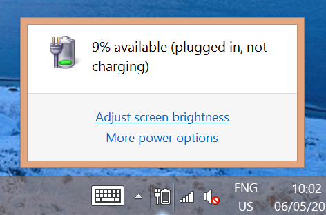

However, whenever I plug it into any other USB port to charge it (such as on my PC), I get the "Plugged in, not charging" message).
I suspect a faulty micro-USB connector (a poor replacement for the old magnetic ones), but wanted to see if anyone elese was having trouble with either the supplied charger or charging from other USB ports.

what's more likely is that the USB ports that you've used can't provide enough power to charge the device.
