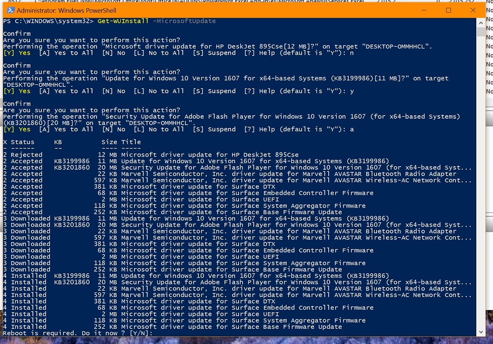

    2016-11-01T21:28:13+00:00
    I installed these plus KB 3197954 and more on Oct 28, and still have the same problem:
