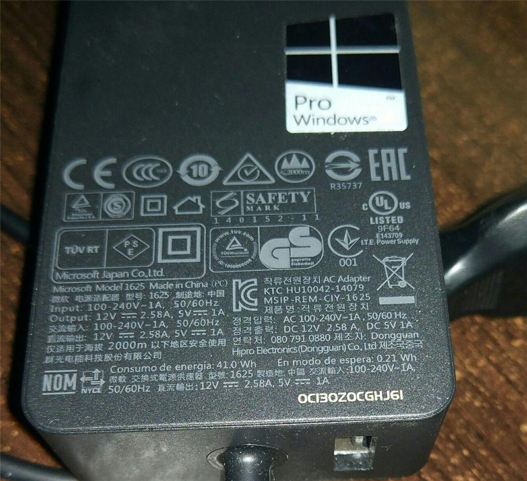

    Does the Surface Pro 4 use the new 15 Volt charger like the Surface Book? Or the older 12 Volt design? I find the problem is worse when using a 12 Volt "car" charger. It tends to stay in the "not quite sure it is charged" state longer than the official 15 Volt supply. With 15 Volts I eventually get through that and the status stops cycling.
