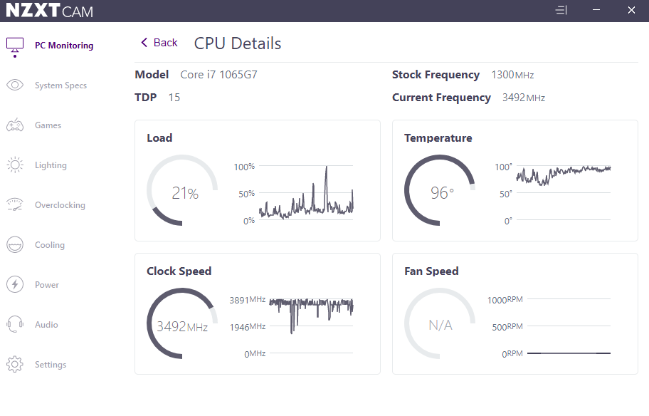

    @jeffrelLODell Yeah I got them to do a pre-exchange where they sent me a new one before I sent my old one back. They just held it on my card.
    The new one is worse than the old one. Don't know what to do now. Look at the below.
