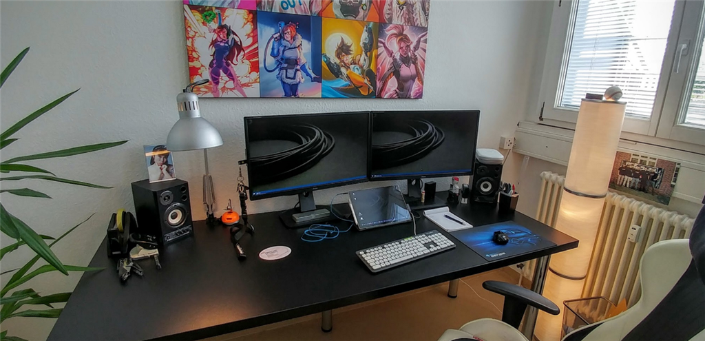

    Finaly I got it working.
    I use 2x Monitor 27" iiyama B2783QSU.
    The Monitor have DP/HDMI/DVI withthe Dock I could try whatever I want "NO SIGNAL" was the result.
    After some hints here from other Users I tried several Active Mini DP to HDMI Adapters, now I finally found a reliable working one which give me QHD Resolution.
    Cable Matters
    ini DisplayPort (Thunderbolt™ Port Compatible) to HDMI/DVI/VGA Male to Female 3-in-1 Adapter Product ID: 101020
    I need to use the HDMI Port on the Cable Matters Converter with a HDMI -> DVI-D Cable. Funny HDMI-HDMI Isn't working too.
    Surface 4 -> Dock Cable to Dock -> Dock: 2x mDP -> HDMI -> DVI-D
    Now I have my Setup up and running, after 4 month :)
