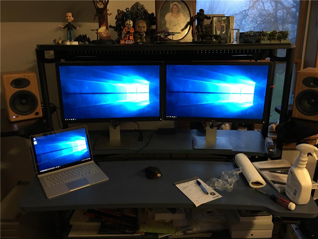

    I just got my two Dell P2715Q 4K monitors delivered thanks to Amazon and have them both working successfully on my Surface Book.  I have the primary display connected to the Dock via the included display port(DP) cable and the secondary monitor is connected to the first monitor.  From within the monitor settings I have the primary monitor set to MST - Primary and then on the second monitor, it is set to MST - Secondary.
    The monitors are both running at 3840 x 2160 30Hz, and the pictures of both a stunning.  I would much prefer to see them driven both at 60Hz, but when I look at the display settings the monitors are only using the embedded Intel 520 video card instead of the dedicated GPU.  It would be nice if Microsoft updated the Surface Book with a settings or toggle that allowed you to select which video card you were using by default.
    Here is how I have it set up now....
