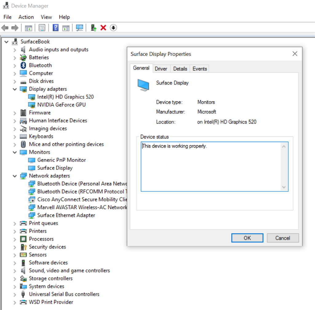

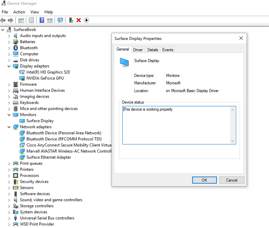

    I am now on my 3rd Surface Book. I first purchased the i7/256. Microsoft sent me a replacement. That also did not work. I then returned it and purchased the i7/512 model. I'm having the same issues. While they advertise there is an dGPU in the device, I call B.S. I have the Surface Dock with two monitors and it will only drive one of them. Each one will work individually, but when they are both plugged in only one will work.
    In the Device Manager it shows (in the properties) that it is using the Intel 520 under 'Location'. If I disable the Intel 520 adapter, it shows it is using a Generic adapter. So how does one go about confirming the dGPU is actually working? About the only thing I'm able to confirm is that the adapter shows in the Device Manager. Here are two screen shots of the before and after when I disabled the Intel 520 adapter.
