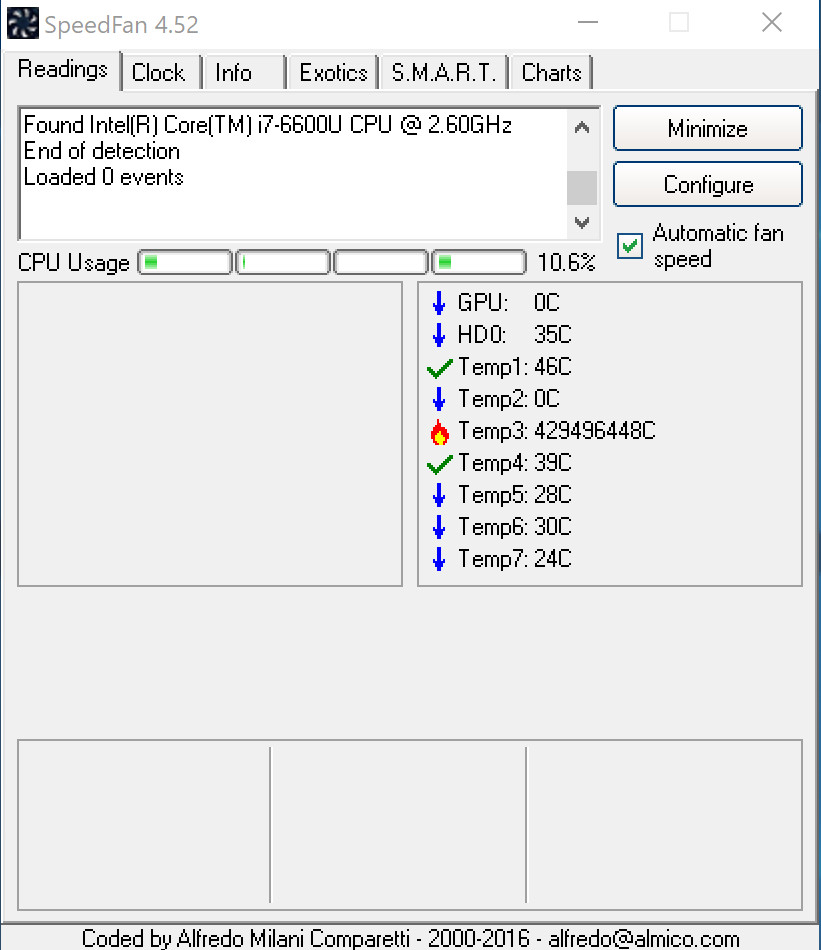

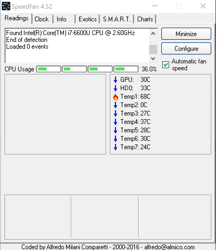

    I have, in the past 2 weeks:

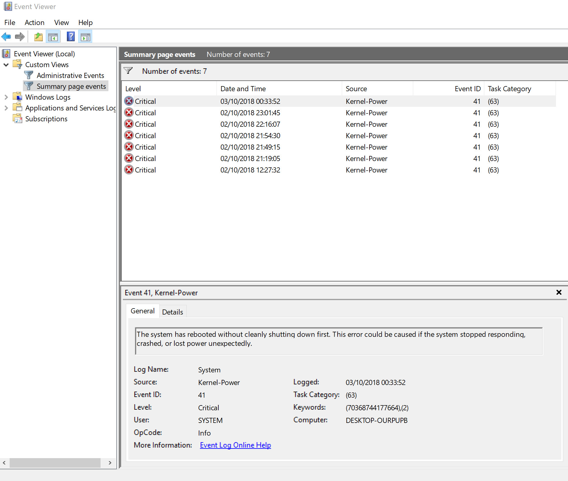

    After Windows update on/around 20th September 2018 battery 1 has stopped charging AND if I unplugged the PSU the surface book would switch off. I then updated the both battery drivers (now its "Surface" driver) but the battery 1 would still remain "not charging" whilst if I removed the PSU the laptop would not switch off. What occurs now is that whilst charging the battery 2 I have switching off of the laptop (based on the event report with Kernel 41 critical error). I have reset the Windows, image reload etc and have installed the "SpeedFan" to see the temperature sensors and this is that is happening.
    Picture 1: Plugged in (Battery 1 not charging/ Battery 2 charging)
    Picture 2: Unplugged (on battery 2)
    I have not option left other than to send the unit to US for repairs (after 2 years).
    The unit is i7/16Gb/512Gb...3299 usd
    Event error:
