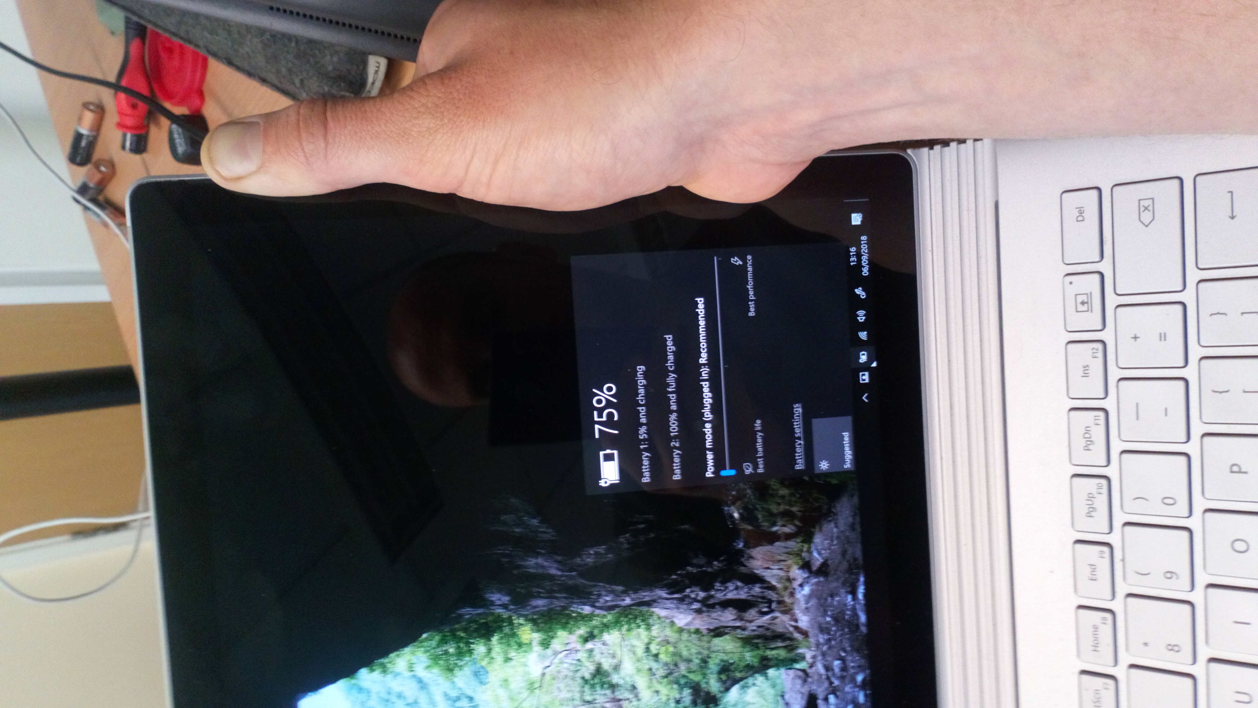

    It sounds like you have the same battery issue as me. The batteries are glued in. With use/heat they swell and the connections become loose. This is a manufacturing defect that microsoft refuse to acknowledge (plenty of info on google); if you are in the UK like me they will charge you £500 for a replacement. The replacement won't fix the underlying fault, and they only give a 90 day warranty, so it is likely that the problem will happen again.
    You can test the connections by 'twisting' the top of the tablet part whilst the Surface Book is on charge. You might find that with a bit of fiddling the battery starts to charge (see the pic below where I'm bending the top of the screen back), but once you let go it will stop charging.
    In summary/TLDR:
    The battery connections are loose. Microsoft won't fix it. In future do what I'm going to do and buy elsewhere.
