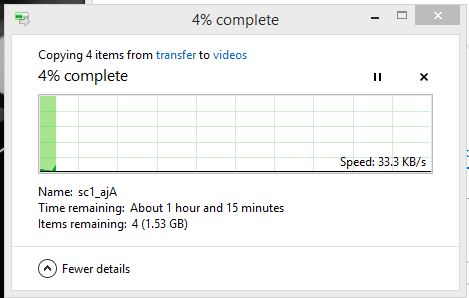

    Hi.. My dock arrived about two weeks ago (UK launch date), It is connected to a iiyama XUB2790HS with a direct cable (no apple adapter) from Mini **** to a DVI input.
    For a few days it seemed fine. I carried out a firmware update and it basically became troublesome. If I undock the SP3, then re-dock 95% of the time my external monitor will not work. I can find no real way to make it work again except for hard reboots, pulling cables and re-inserting.. Its a mare.
    I contacted support last week who have arranged for a new dock to be sent to me. Nothing has arrived yet, they are telling me there is no stock to ship. In all honesty, I'm not convinced a new dock is going to fix this issue. I think it's clear its a firmware problem.
    My screen sometimes pulses on and off.. I've found if I press windows button+p at this point I can normally get the screen to work again, until I have to redock or restart the sp3.
    Not sure if this is related but I will throw it into the mix anyway, just in case.
    My mouse periodically disconnects and reconnects
    My surface pen stops with no warning. I have to unscrew the top and screw back on to get it to work again
    my transfer speed is too slow.. If I plug a drive into usb and move say 1gb of data, it can take over 2 hours to complete.
    Got to say MS.. you have some serious issues to resolve..
    SO.. Why the heck I love my sp3 so much is beyond me. LOL.. Can you imagine the business you coul dwin if they actually worked as they should do?
