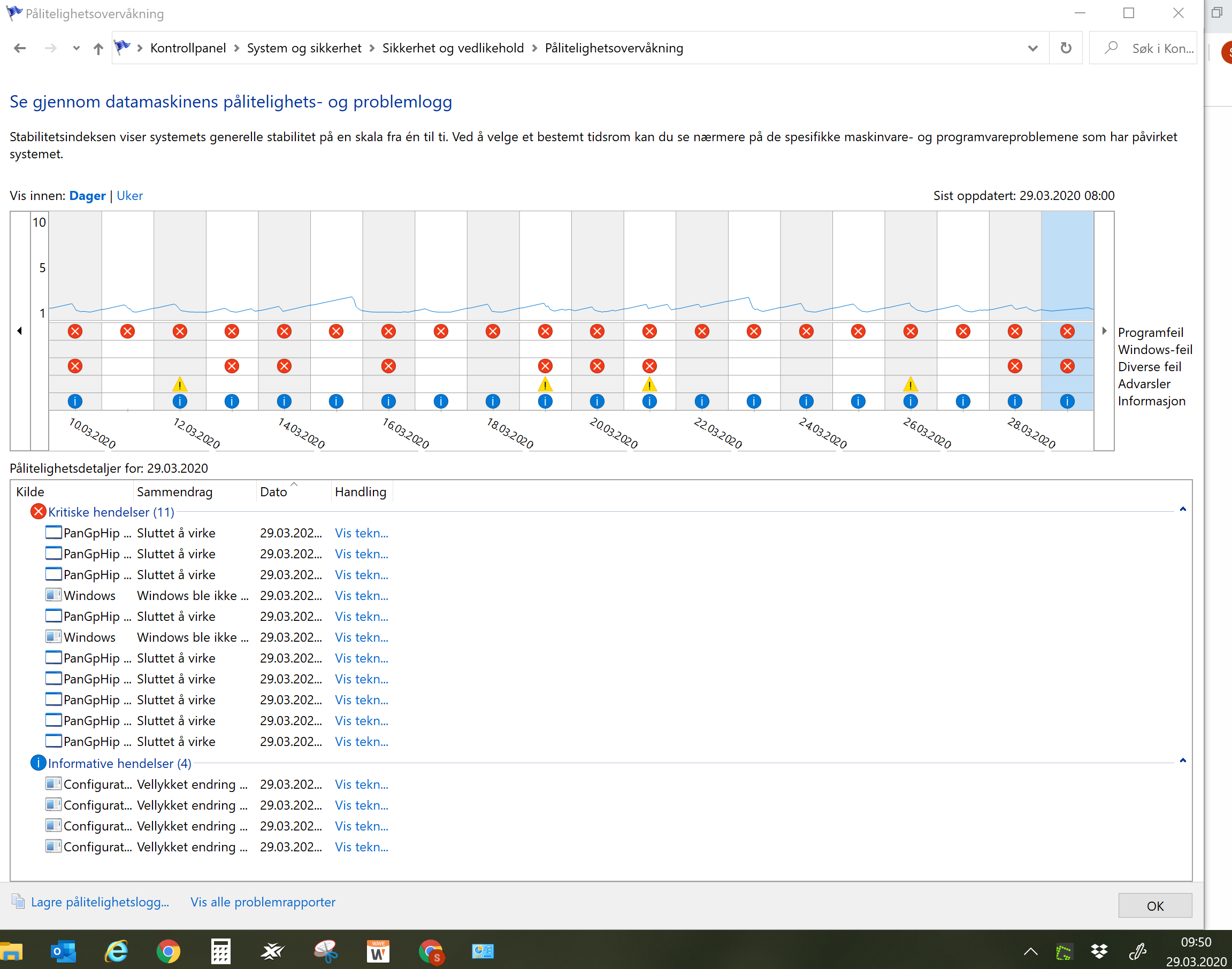

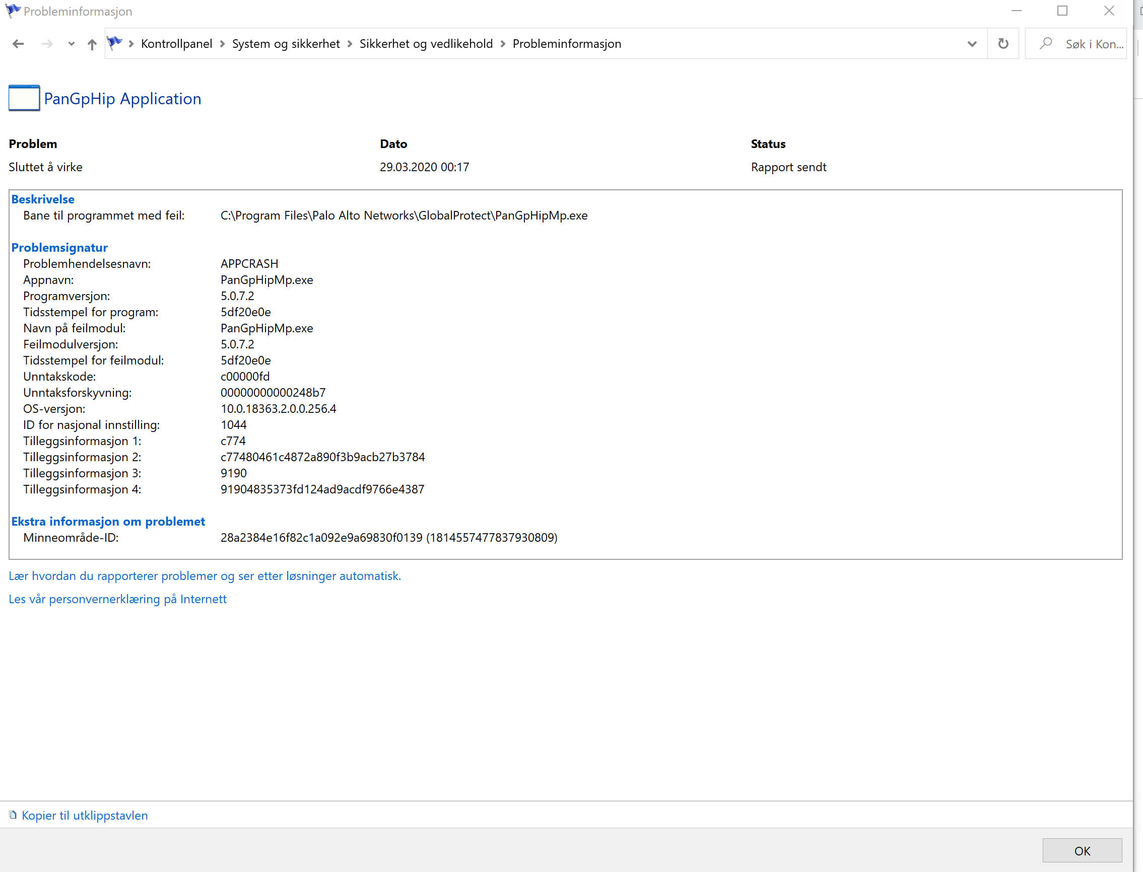

    2020-03-29T17:29:00+00:00
    Hi.
    I have the same problem.
    My PRO 7 turns off when I don't have my eyes on the screen and only when running on battery power.
    Sigvard
    Scro through this thread and try Option 4 in the list of workarounds for the issue. Let us know if it helps in your situation!
