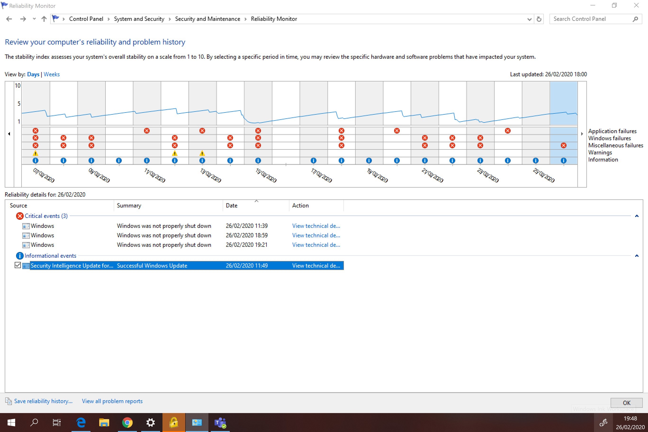

    My surface pro 7 i7, 16GB 256GB, has randomly powered off 3 times today when running on battery mode. In fact, overall, reliability is very poor, as seen in the attached figure.
    I often have issues when I leave it unattended for some time and it goes to sleep not in a good way (i.e. when I wake it up, all apps have closed, so it seems to be the equivalent to a power off). I have auto-update on, and today's crashes occurred after the last update check today. Crashes while using it like those experienced today (the screen just goes all black, as in a power failure while I am typing on the surface cover) were not common in the first month - I bought this unit in December. Is this likely a hardware issue?
