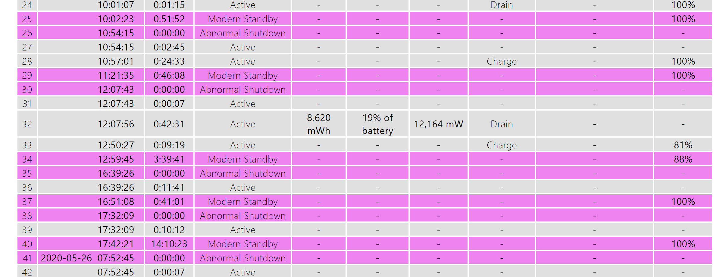

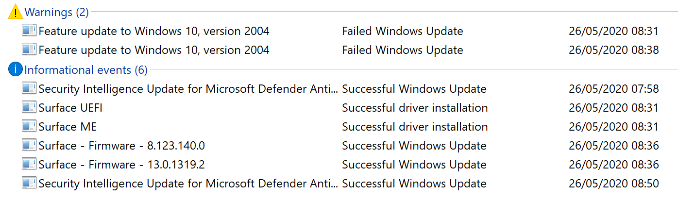

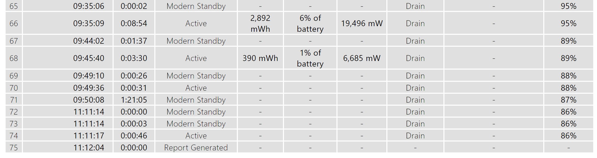

    Woah - please ignore my previous reply. Although I failed to update Windows 10 to the May edition, the latest firmware updates did install:
    And now I've turned Standby back on and my sleepstudy report has gone from this:
    to this:
    ie, the device which could never sleep without crashing has been sleeping and waking up fine for the last few hours. From my perspective the latest firmware updates have fixed the problem. However, for now, I will keep the latest Intel graphics driver and display refresh settings the same, in case setting back to default breaks things again.

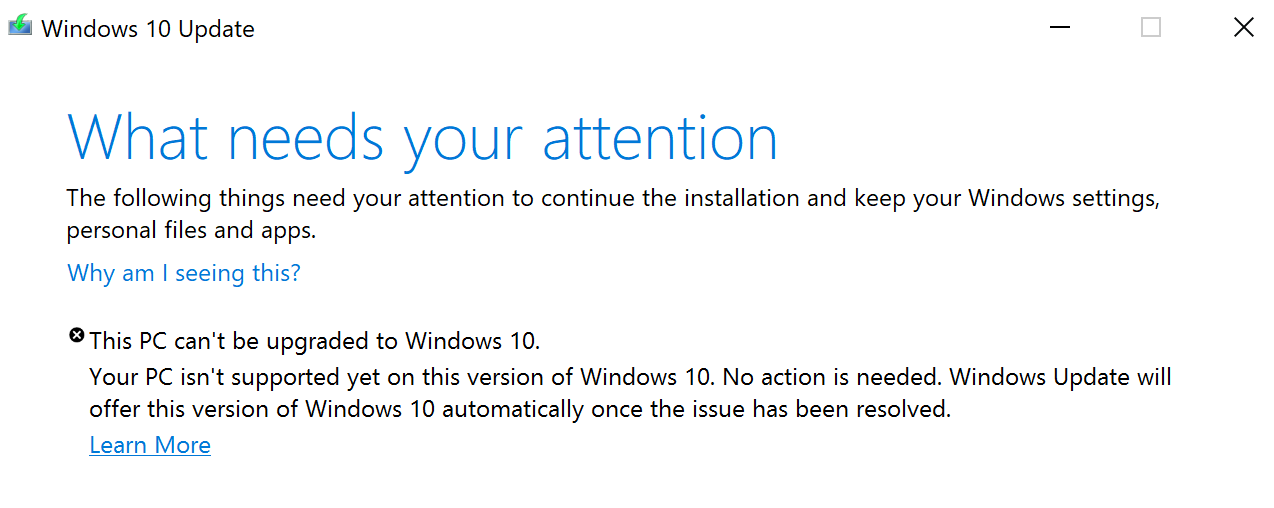

    Darn - it looks like they've pulled the update for Surface 7, as I got this:
    Taking me to this link: here.
    I've tried all the solutions and nothing has worked. Once my Surface goes to sleep it crashes, so it does a full startup when I turn it back on, losing current state and work in progress. My only solution has been to completely disable sleep, whether on battery or external power which means a slow startup, but at least I can leave work open.

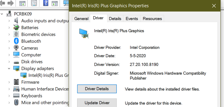

    So I went for Option3. I did not install the driver from the link, but the latest.
    This is the driver that is already ready for 20-04 release. After installing this driver, I've been good for 4 days now.
    Don't worry about installing an intel driver over the standard surface driver. I've owned many surfaces (3,4, 5, 6 and now 7) and on several occasion I installed the latest intel driver to circumvent an issue. Microsoft will release an updated driver later no doubt, but for now this is good. You might notice that windows will re-apply the original driver at some point. Then you simply repeat the install.
