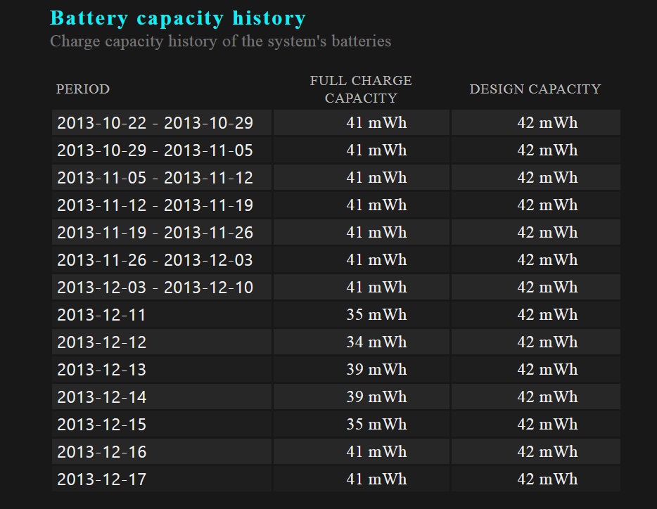

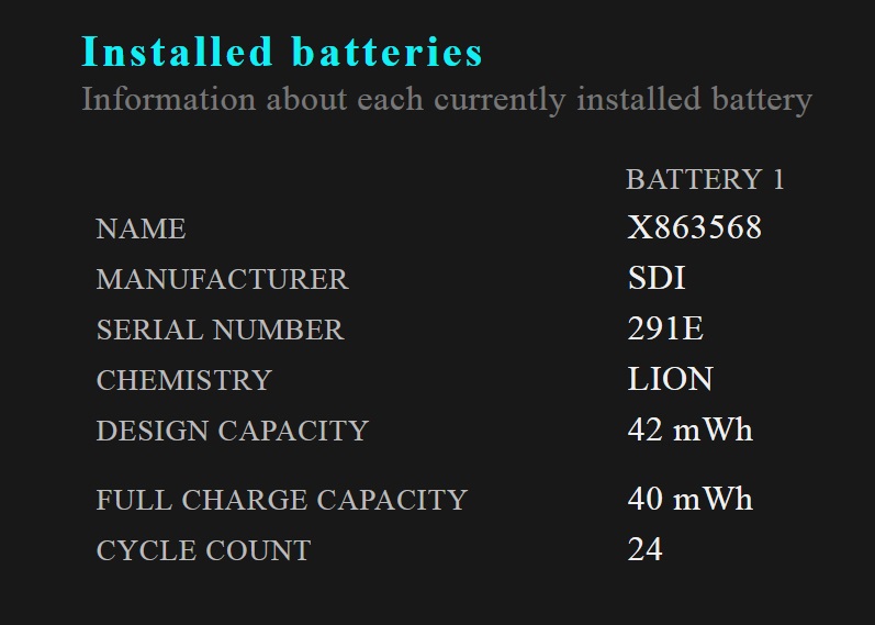

    2013-12-18T14:28:43+00:00
    Same battery capacity dropping her, unbelievable:
    (2013-12-16  hold volume button+ and power button15 sec solution)
