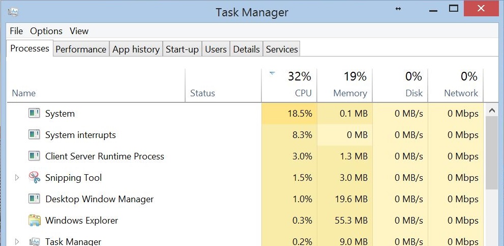

    Following the botched update I'm seeing the below symptoms:
    • SP2 goes to sleep but then wakes up instantly
    • System Process using CPU when IDLE following Power Plan setting sleep timer (Investigation with Process Explorer shows ACPI in the Threads stack using CPU)
    • Type Cover keyboard light turns on and off constantly when SP2 not in use, draining battery
    • Battery calibration not working correctly (fixed with several discharge / recharge cycles)
    • Battery not holding as much charge, indicated 23,000mWh vs designed capacity 42,002mWh (fixed with several discharge / recharge cycles)
    I've read through the posts and not seen ACPI or Type Cover lights mentioned, is this the common behaviour or am I alone?
    Thanks all, hoping the 'fix' will sort out the above!
