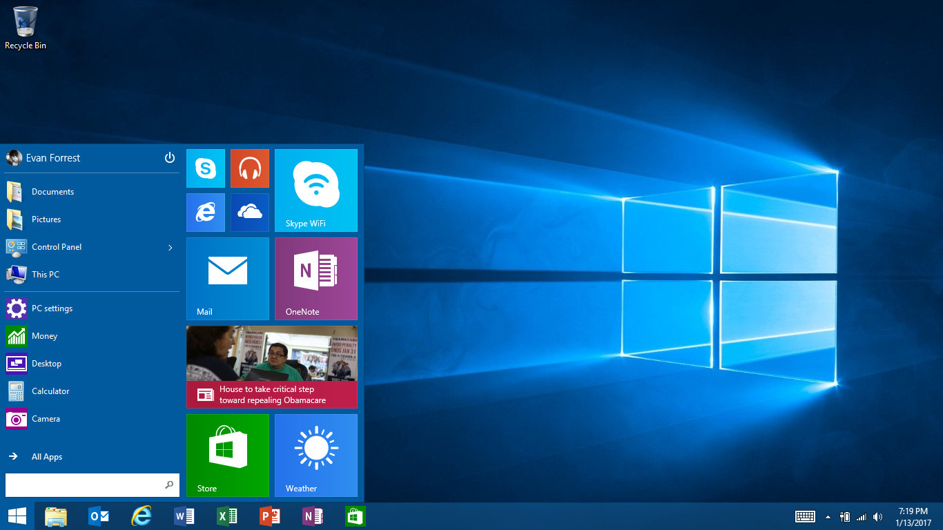

    I have finally found a solution (now I have a start menu at the boot up):
    ISSUES I had:
    1. After resetting Surface RT, I have installed all the windows updates including KB3033055. Then as many experienced here, black screen with blinking Wi-Fi icon on the left bottom screen appears, making Surface RT unusable. Reset several times. But no go.
    2. I tried all the methods given here, but no solution for me. Whether I installed KB3033055 as a standalone or not, same issue remained. If you do not install this update then start menu will be like that of 8.0. But if you want to see this:
    1. THEN KB3033055 is NOT start menu UI. It is not Update 3. So DO NOT install KB3033055 from optional update. Standalone Update 3 is: KB3097667
    2. There is a better and easier way to update all this without the hassle of KB3033055.
    Follow the link and read through. I have only used No 8, "More Information" that shows the link to Update 3 Standalone (that brings back start menu above). Depending upon the browser you use, you maybe blocked initially (but disable it temporarily, and it will lead you to MS download website).
    https://surfacetip.com/install-windows-rt-8-1-update-3-2017/
    Now I have above start menu and all the updates installed, however, I did not install any of the Optional Updates including KB3033055.
    Hope you will find this helpful.
