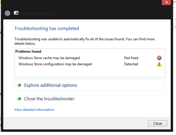

    all i can say from what i have tried is if you have any documents or pictures saved on your Surface RT tablet save them to a flash drive and reset surface basically reinstall not saving anything like you just got it in other words  retest back to factory settings and then install all apps that you want from the app store then they are saved to your account in the app store then you can access your account and install apps from there i tried this it works you can install apps from your account in the app store so just do this and you should be fine i guess everybody will have to do without the start bar unless foe some unforeseen reason Microsoft decides to fix this problem and i doubt very much they will do anything but at least it will still fully function. and this is what i keep getting when i run the troubleshooter program.
