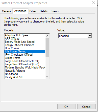

    Thanks AdamC. I did make the changes from your earlier posts but came in this morning and had the issue again within 5 minutes of my first teams meeting.  looking at the Ethernet Adapter Properties in the device manager I see the image below. I have these docks: Microsoft Surface Dock (PD9-00003)
    2020-06-09T04:37:38+00:00
    I would play with advanced powersave settings, but these will depend on type of dock you are using. If you post list of settings, we could try to guess.
    2020-06-09T04:35:12+00:00
    See my response earlier in the thread (29th of March). Setting MIMO power save mode to 'No SMPS' resolved the issue permanently for my SP7.
    2020-06-08T22:12:50+00:00
    I'm having similar issues not with WiFi but with my Ethernet on my surface pro 7.  I thought it was a faulty surface dock or my home internet connection but I'm having the same intermittent "connected - no internet" message and dropping from Teams meetings while at my office that has a different surface dock and internet that is working for everyone else in our building.  Are there Surface Ethernet Adapter settings in the device manager that I can change to resolve the issue? Help is very much appreciated.
