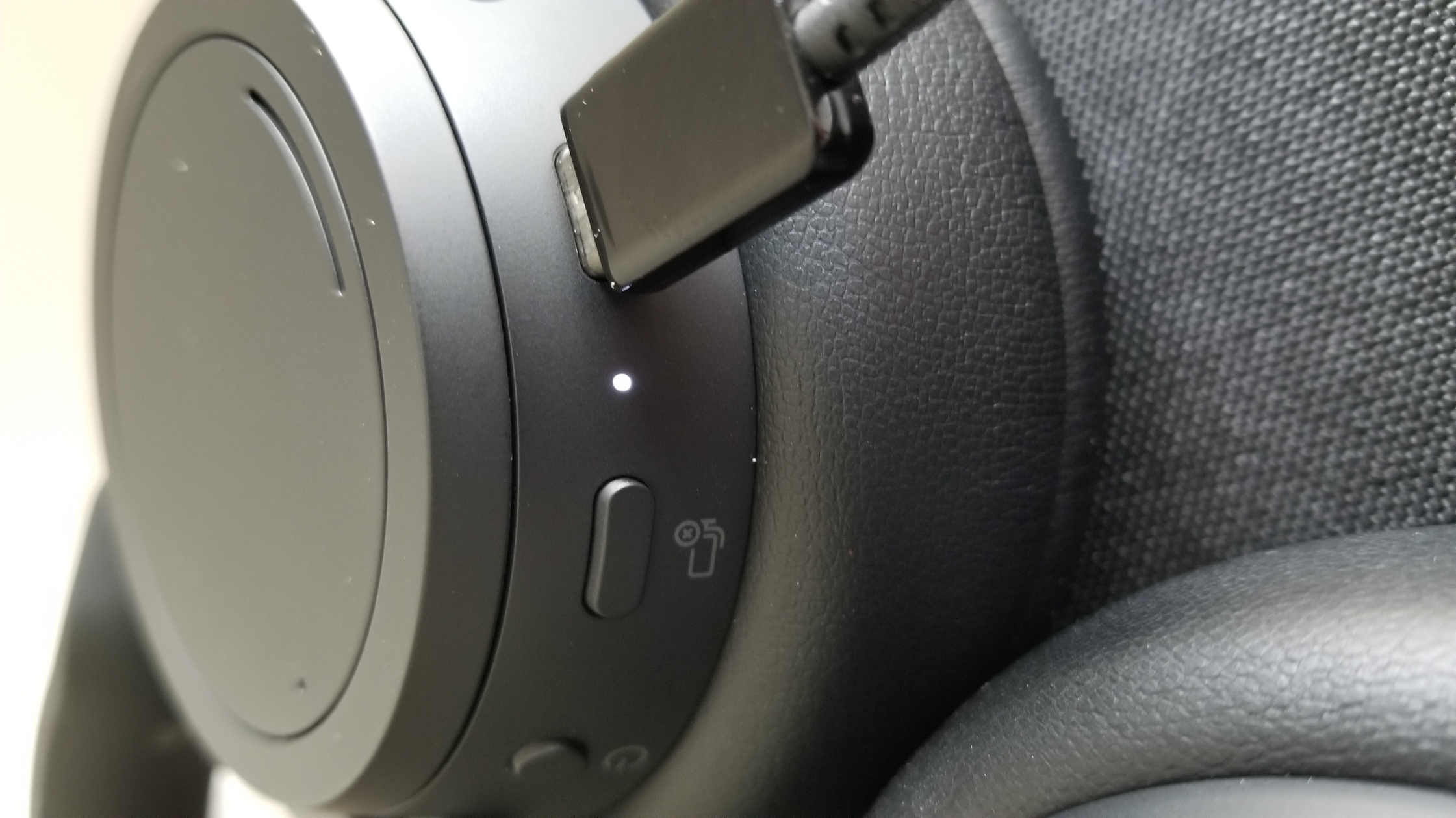

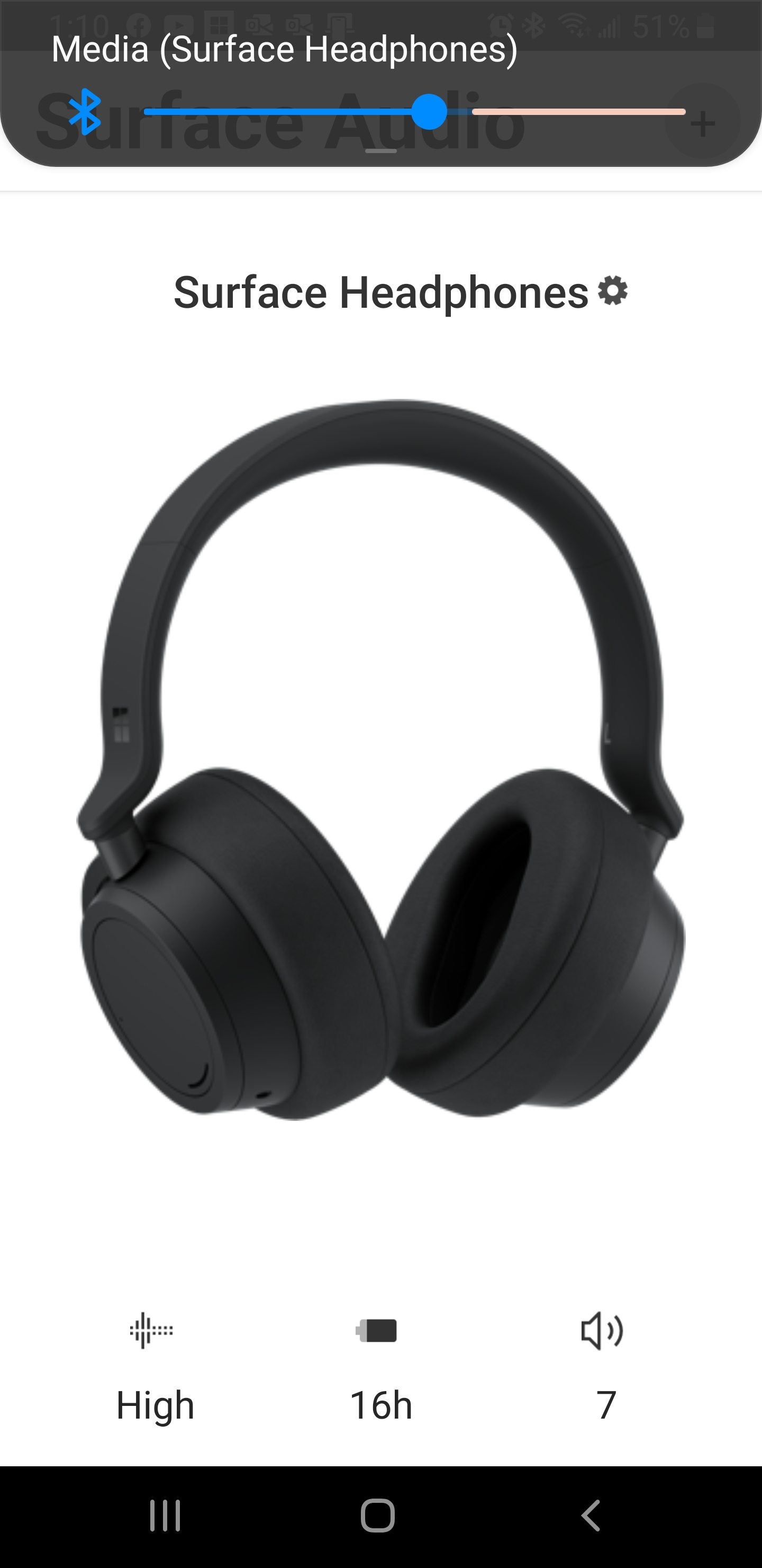

    2020-06-19T17:27:17+00:00
    Janette,
    I have provided a few screenshots to show what I am seeing. I also provided a picture of the LED notification light sold which should mean battery is fully charged. This time when i charged it only went up to 16 hours.
