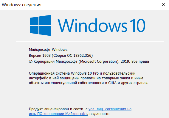

    2019-09-19T16:02:54+00:00
    forgive for my English.
    I from Russia.
    and many screenshots in Russian.
    insertion=firmware
    reset=reboot PC
    I did not update Windows 10 1903, only install firmware

    Please run
    winver
    and reply with the full build number shown.
