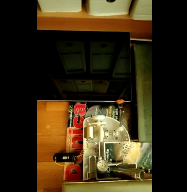

This morning my surface book downloaded some firmware updates and asked for me to restart my device.
(Here's the details on the update: https://support.microsoft.com/en-gb/help/4023488/surface-surface-book-update-history )
However, after the first restart, I find that the surface book is in a constant restart state. I cannot even force it to shut down or boot the UEFI menu.
This is exactly what it does:
Every 10 seconds or so, it will turn on, show me the "Surface" boot logo, and after 1 second immediately turns off. It does not even reach any Windows boot up sequence.
I found the following topic which advised doing a few steps but nothing works:
https://answers.microsoft.com/en-us/surface/forum/all/surface-book-stuck-in-continuous-restarting-loop/91bc5782-aabf-4555-847a-05b92c88da6d
Could I please get some advice on what to do or how to fix this?
Thank you
Update: Seems the common factor between everyone who is having the issue is that the secure boot is disabled (I.e. there is a 'red strip' shown with an unlock icon being shown).
