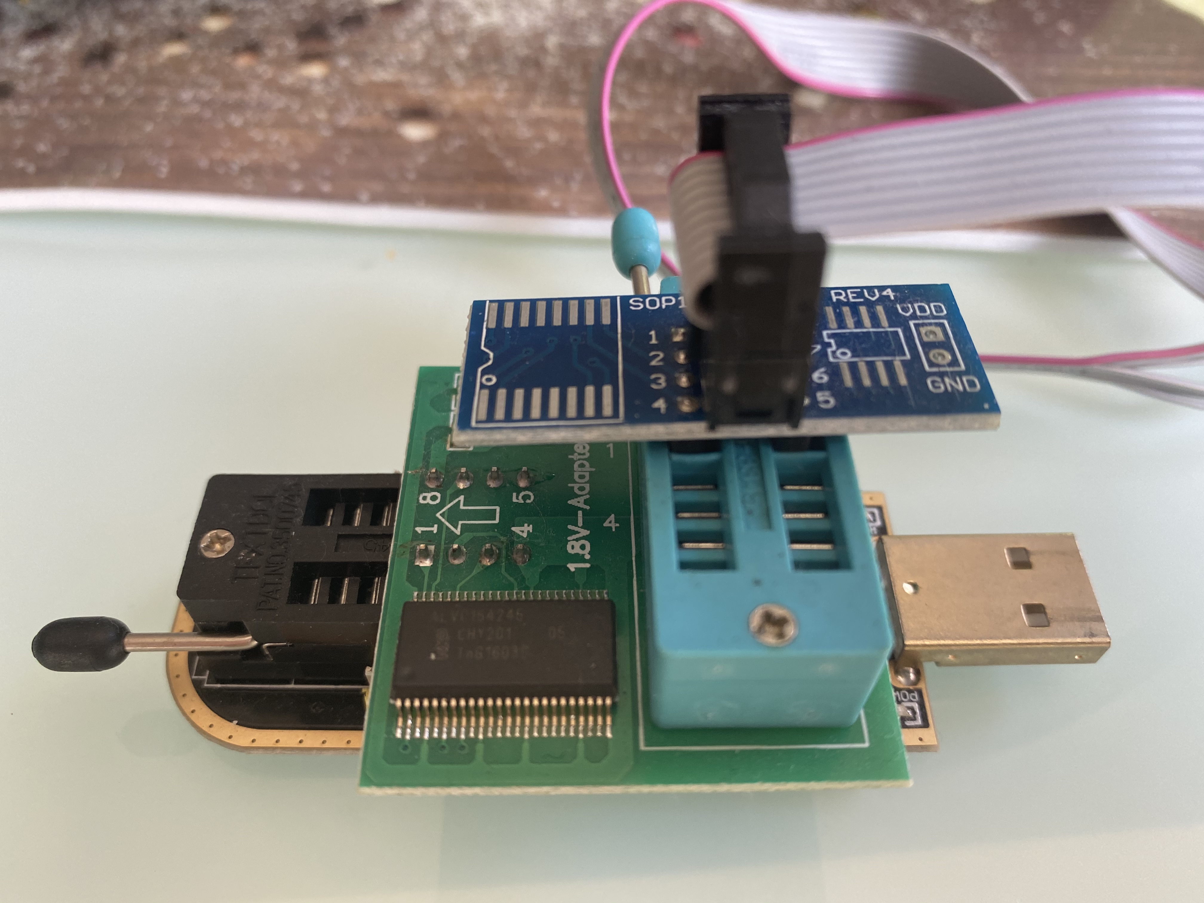

    i have winwond 25 series flasher .. but i do not havw BIOS file .. i also open laptop and even i can open board to reach and flash but need correct BIOS. Microsoft, if you are looking this thread then atleast share BIOS bin file
    How did you manage to reach the flash? It looks like an extremely tight fit for me because there's a metal shield around it.
    I'm trying to give this a go using the Pomona 5250 SOIC Test Clip (i.e. I don't want to unsolder it from the board).

    ![](https://learn-attachment.microsoft.com/api/attachments/5823b79d-aa94-4efa-ace5-0e5bc070f8a0?platform=QnA
