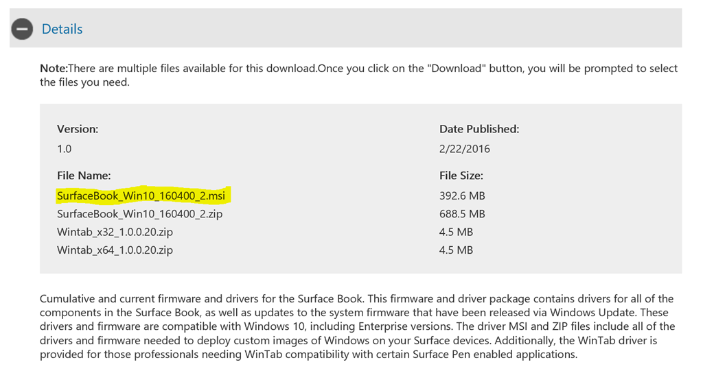

    For those of you not able to get the drivers installed, can you please try installing the update from our MSI package which is now available for Surface Book from our download center. This was just published last night.
    Let me know how that goes.
    Thanks,
    Greg

    I also tried installing the MSI (downloaded today) and it didn't help.

    With this latest update, I decided to try the msi which was published yesterday. I am again seeing the same errors. I have tried everything mentioned in this thread without any luck.
