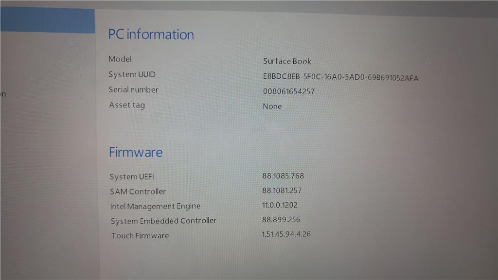

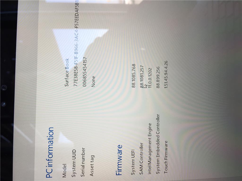

    2016-02-22T17:08:43+00:00
    Here's a screen shot of my firmware screen.
    2016-02-22T17:11:27+00:00
    The 2/17 firmware versions are:
    EC       88.899.256.0  SurfaceEC.inf
    ME       11.0.0.1202   SurfaceME.inf
    SAM      88.1081.257.0 SurfaceSAM.inf
    Touch    1.0.0.0       SurfaceTouch.inf
    UEFI     88.1085.768.0 SurfaceUEFI.inf
    So YES you have the latest running.
